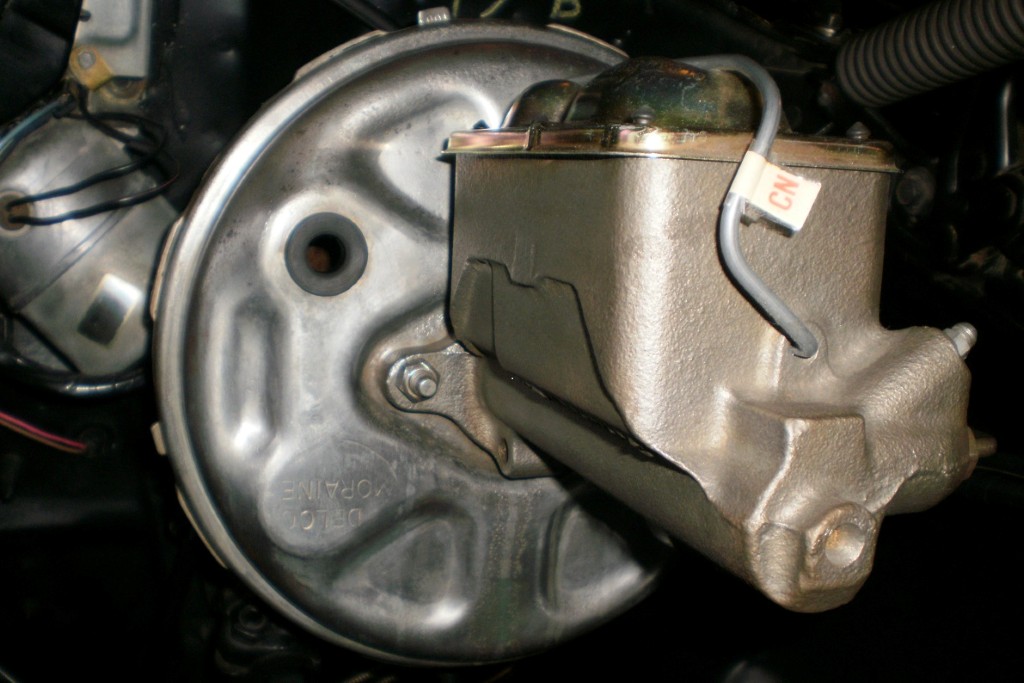

Can you guys tell me if this is an original booster or a reproduction.
Thanks,
Dave

0749 is not a 69 camaro for sure!
not sure what it is and if it was a 69 camaro the Delco stamp should be on the other side upside down.

Looks like a OE unit to me. Not all were stamped 180* and upside down. Some were not stamped all. EZ to spot a Chi-Neez one. half the cars restored now have the El cheepo ones installed.
Easiest way to tell is to compare the "Triangle shaped stamped in stiffeners. The repops are very sharp at the bottom with a distinct hard line, the OE ones have a nice smooth radius.
Next time you watching a auction on TV zero in on the under hood shots, you'll be amazed. [img]<<GRAEMLIN_URL>>/shocked.gif[/img]

Mike, you are a smart cookie! Amazing how much the Chi-Neez restored cars go for in some of these auctions.

I've also noticed that the &quot;DELCO MORAINE&quot; is very crisp on repos and somewhat less distinct on OE. I too have seen upright/right side &quot;D..M..&quot; stamps on correct OE boosters.
I guess you are right Sammy, Mikey is a &quot;smart cookie&quot; [img]<<GRAEMLIN_URL>>/biggthumpup.gif[/img]

Check out the &quot;O&quot; in Delco. Repops have a rounder O.

That's true,among other subtleties.
Vintage used an 0.
Todays Repro uses an O.

what is an 0749 booster......am i confused?? Thats not the date, correct??

Eddie - seems like its a 1967/1968 booster for a power assisted drum brake car? Was there even such thing?
http://www.firstgencamaro.com/suspension.html
