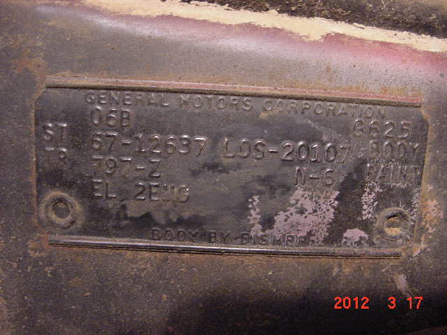

I have a 67 Camaro ss number matching 06b 67 with out the 4p in the cowl tag. Also can not find anything on the 6 after the paint code? Anyone have any information about this

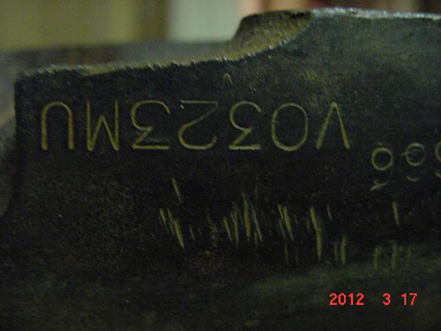

block stamping, powerglide

I would contact Kurt or William at CRG if they do not chime in here soon. I know that code had to do with body stampings, etc. when the car was being assembled at the fisher plant, but I would not doubt it is possible, as there is a real X-11 Z-28 locally in my area.

In reverse-same kind of issue discussed here: http://camaropacecars.com/eve/forums...3/m/2931078426

Here is the post about his car on CRG.
http://www.camaros.org/forum/index.php?topic=9332.0
<div class="ubbcode-block"><div class="ubbcode-header">Originally Posted By: 70 copo</div><div class="ubbcode-body">In reverse-same kind of issue discussed here: http://camaropacecars.com/eve/forums...3/m/2931078426 </div></div>
Not really. The tags have been swapped on that convertible.
