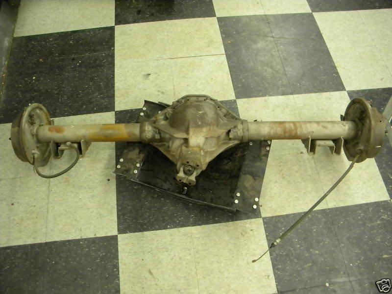

I just got a 68 camaro this past weekend it is a clean street car with 60,000 miles but it is a standard coupe with a 392 small block stroker and dart heads. I wanted the car to play around with and for the money I figured I wasn't getting anything special. But like any muscle car head I started pulling numbers and when I got to the rear I about pooped my pants. I pulled the cover and it still has the original ring and pinion in it and inside was really clean. The only thing that I noticed was the pinion seal is starting to seep a little oil and someone put a low rent chrome cover on it. but I ran every # I could find and it is spot on. I just gave all the #'s to a buddy of mine who is a camaro junkie and he is double checking everything for me. Anyways I was wondering what this thing is worth I would like it to go to someone that has a copo and not an original rear, Instead of my weekend street beater and occasional cruise night special. Who knows maybe I can get enough out of it to get a new 12 bolt and my car cleaned up a little more. I will post the #'s later tonight or tomorrow and I can get pics up this weekend

Ok the rear is in the car of course so I cant get real good pics, but I will try this wknd. For now here are the numbers: axle tube, B E 0513g1 then of course the E underneath for eaton. The ring gear number: 1 gm 39162261041569 and the number on the pinion gear: 693916228 41gm. like I said everything is in really good shape inside and it doesn't look like it was ever torn down. If this isn't a copo rear don't beat me up too bad I am a newbie with these cars. and I would also like to know what numbers if any I could check on my trans it is a m21 and I think it is a close ratio( it feels like the close ratio in my uncles gto fast shifting through third then fourth seems alot higher) the reason I asked is the guy I got the car from said the previous owner told him the guy he got it from put the rear and tranny in it from an old camaro that was going to be junked. Who knows I may have a tranny too! oh yea what is this thing really worth, not what people are asking and not getting, but real world money?

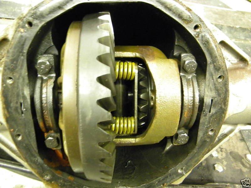

The numbers that you posted, 3916226-3916228, are correct for a COPO 4.10 ring &amp; pinion and the 5-69 dating matches the BE0513G1 axle code.
If you want to email the pictures to me, I will size them and post them for you tonight.
If you have a clear picture showing the gears/plates inside of the posi unit I can probably tell you if it has the correct 3916234 carrier too.
