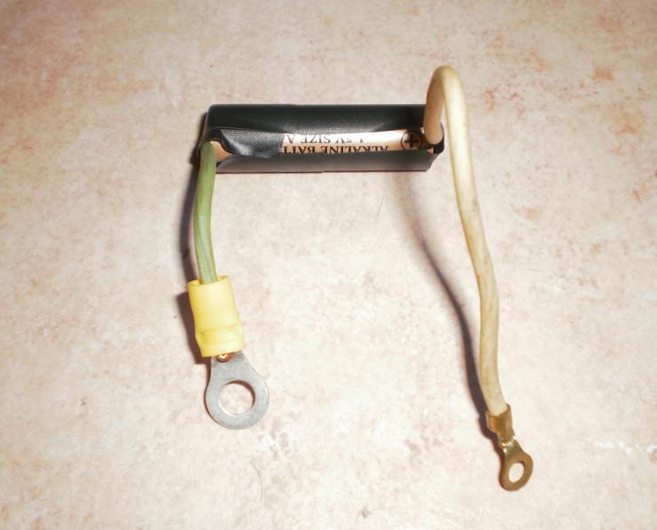

Problem fixed,
I got a new AA battery and added wires tape and held in place with electrical tape, then i hooked them up to the rear terminals on the back of the Amp gauge after removing the top of the dash and stereo speaker and i unhooked the car battery before doing anything.
The needle jumped right back to it's original 12 o'clock spot [img]<<GRAEMLIN_URL>>/biggthumpup.gif[/img]
Here is a photo of the little tool that solved the problem.
