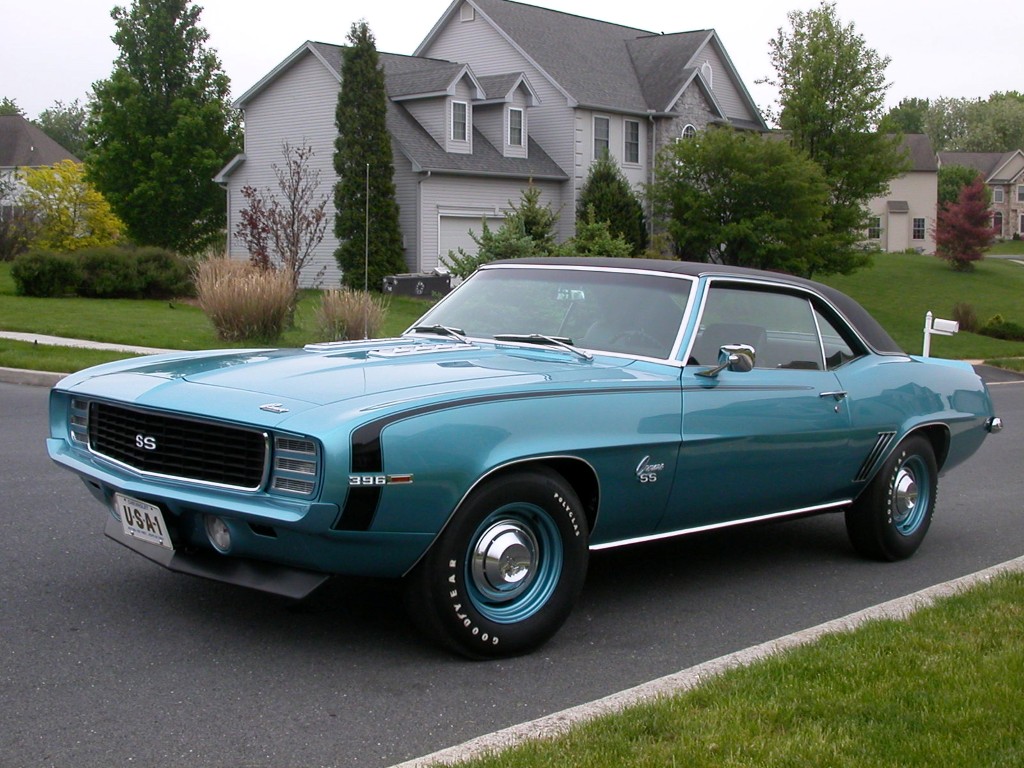

I got my car out on Friday for the first time this year and it fired right up and idles perfectly but after warm up I went to cruise around the neighborhood and I could not get out of first gear, as soon as you give it throttle, it pops and runs eratic. I did not have time to check it out, any suggestions on where to start looking for the problem.
