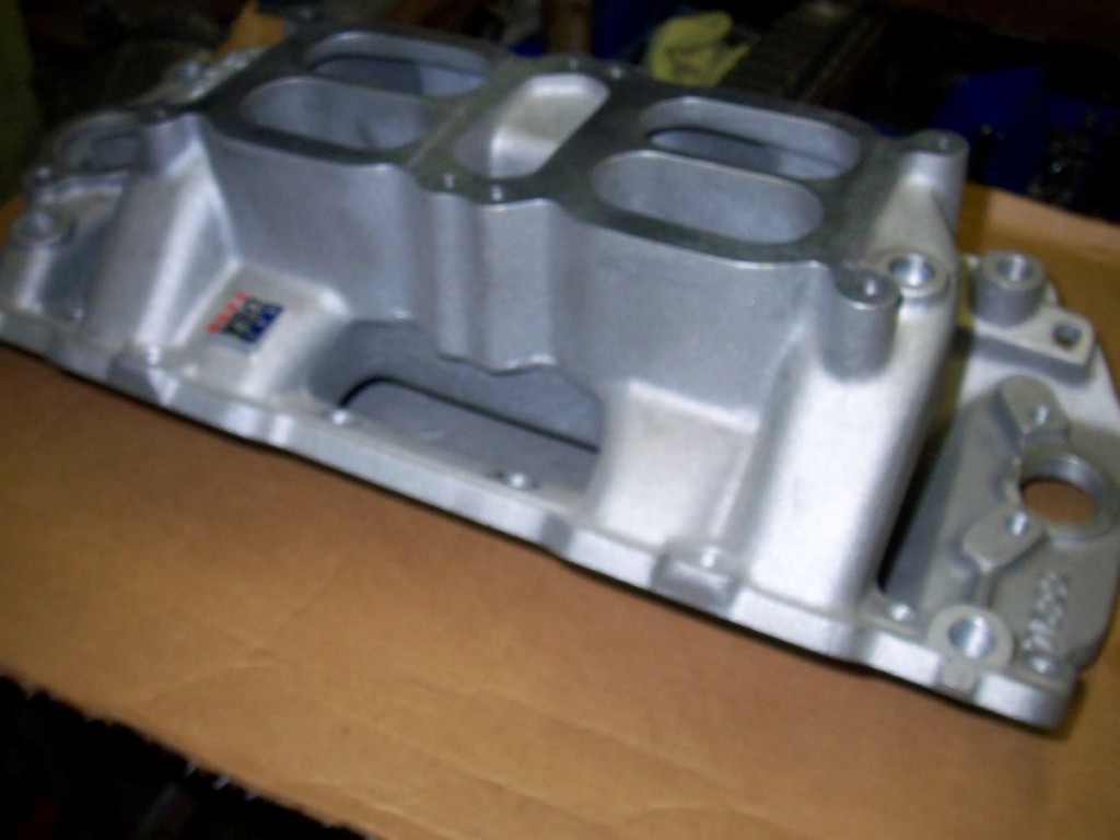

Here's a pic. Not trying to change your mind or anything if your heart is set on a T-Ram but just throwing out there a little more streetable alternative. Edelbrock Thunder Series #1805 (625 CFM) are already pre-calibrated right out-of-box for this particular manifold on BBC's.

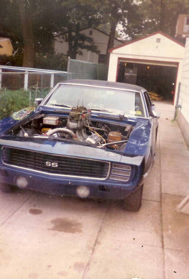

This is the empitome of 1970's day 2 TR's. This is a Weiand, but I don't know the model. It has a pair of 450 carbs, but the ol' 1850 600 cfm are cheaper and easily tuned for this application. I run them on my 327 too.
There is something about the way this intake looks that I really dig more so than the Two Lane Blacktop set-up.
