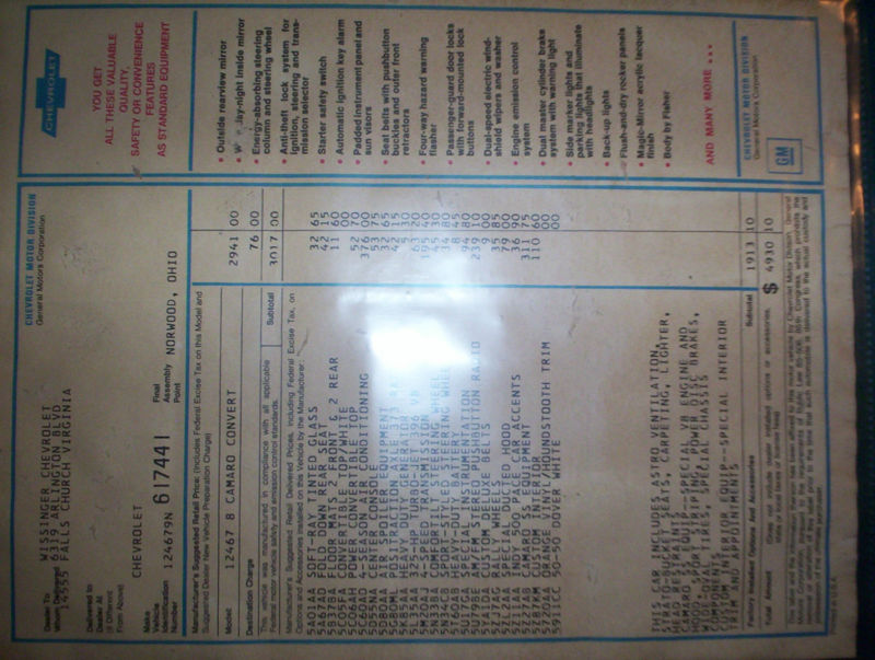

Default Thoughts on window sticker
feedback on this window sticker would be appreciated.

Default Re: Thoughts on window sticker
It is a repro. Z22 was omitted; several ECLs are incorrect and it is missing the body number.
100% modern day reproduction.
