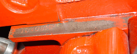

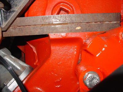

If you look at the VIN`s on this site and on copo.com it seems like all COPO Chevelles were built at the Baltimore plant. But a fellow member on this board told me about one built in California, that must be the Fremont plant.
Then I remembered the engine that was for sale at SCR9. If that one is the real deal, then that COPO was built in Kansas City.
Do you know of COPO Chevelles from other plants ?
Anders Stålklint.
Attachments - The Supercar Registry 251293-enginepad-withbuilddate.jpg 251290-enginepad-straightedge.jpg 251288-enginepad-straightedge1.jpg 251286-vinonoilfilterboss480.jpg

That engine was a restamp you could feel a belly were the old number was sanded off

Yes, John is absolutey correct....future buyers beware this was indeed a restamp.

All the COPO Chevelle engines that I have seen, had the VIN stamped on the deck behind the alternator, not at the back of the block by the ring gear. Anything out of the ordinary will not bring top dollar even if it is legitimate.

I don't know if any COPOs were produced at any plants other than the two mentioned. I have heard about cars and docs but have never seen "originals".
The stampings on this engine are not consistent with other known and documented examples and they do show possible signs of tampering/changes.
