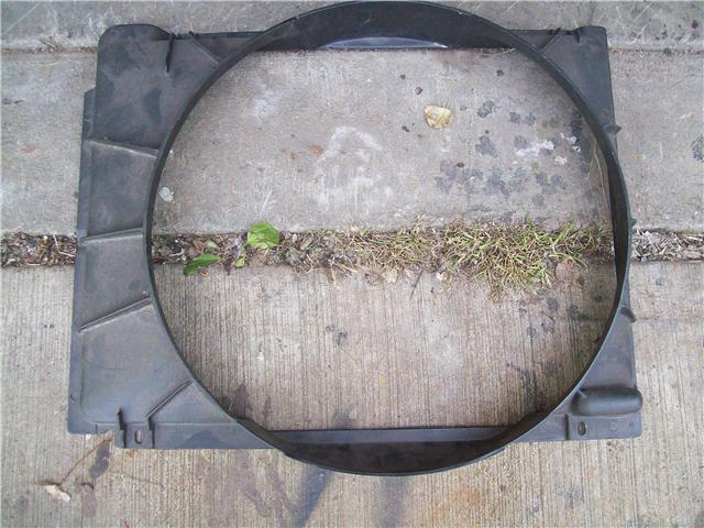

I know the picture is not the best, but can I tell if it is NOS or repop?

pic 2

That's the later issued #914 produced shroud,if that helps.
THAT's the only one of the three original designs that's being reproduced today.
To determine if it's an orginal or a repop,describe the bottom lower outside corner on the passengerside,or post a close up pic of it if possible.

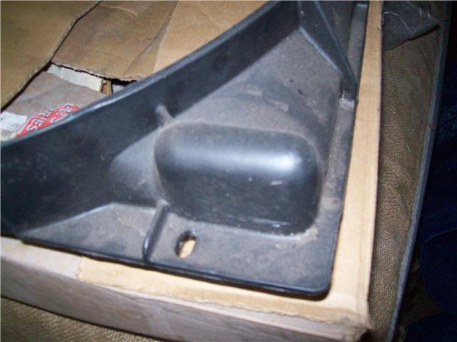

It has a bump there. I will post a pic later. Can you tell me if this is NOS vs repop and what application it would be for?
Thanks,
Marty

pic #3

Can't tell by that.That's the driver side upper.
You need to take a pic of the passenger side lower portion.
