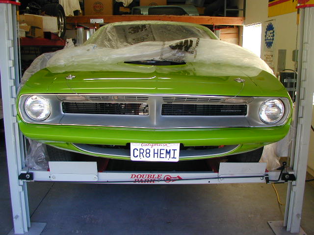

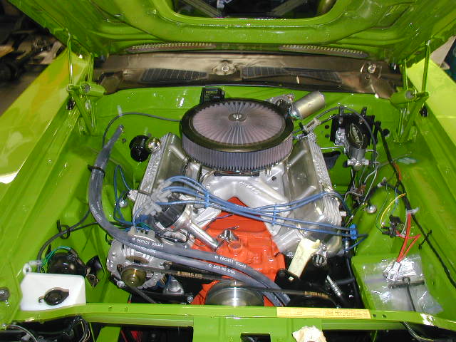

Finally getting around to finishing my Cuda Hot Rod project and it's time for the radiator. Do I go with an aftermarket aluminum version (and if so, which is the very best one and do they make it to accept the OEM fan shroud?) or should I use an OEM style copper one for the correct look and fit?
You will be able to see some of the radiator through the grill so I'm slightly concerned about the visual effect of the aluminum type (minor detail). Trying to keep the exterior of the car to look like a HemiCuda.
I'm more concerned about proper cooling. Engine is 493 cubes/550 HP and I want it to be reliable for cruising... Don't plan on installing an electric cooling fan so far (unless I really need to).

Here's a pic through the grill area......
