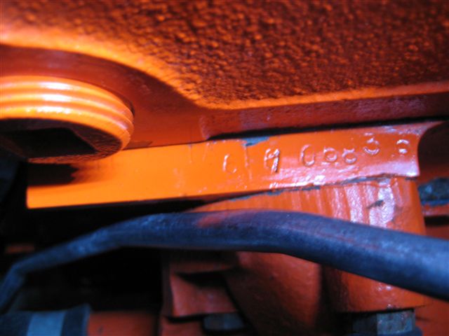

Can anyone tell me if this stamping looks legit? Thanks,Marc http://cgi.ebay.com/ebaymotors/1967-Chev...1QQcmdZViewItem

I think it looks hacked but lets see what the others have to say.. Any imput anyone ????

The vin stamping looks similar to the one on my 67 396 Impala. It was a 100% numbers car

Is there a "T" before the date on the stamp?
