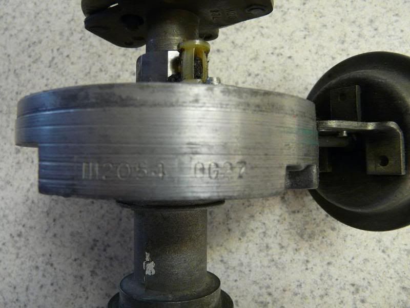

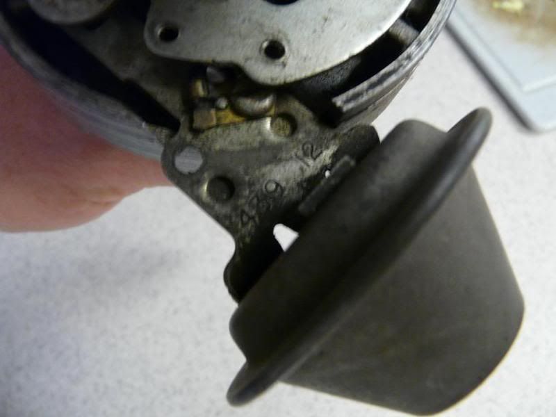

I have been going through old stuff that I will never use, basically weeding out some stuff to help with the finance of my newest project, I ran across a distributor number 1112054 0G27 says it is a 71 Chevelle LS6 auto, did they make such a beast?? This unit is quite clean never blasted or cleaned, also vacum advance is 439 12 but the hose end has been pinched off. I have never seen or heard of a 71 LS6 auto car?? Im at work I brought it with me, I will take a pic and post it when I get home.

Here is a few pics of it, interesting part.

The 439 12 vacuum advance is correct for both of the 1971 Corvette applications. I wonder if it's a service replacement part number?

This one has got me, Look at the date code and the book show's 71 ls6 chevelle with auto, but I have never seen one or???? big question mark on this part. I'm just ?????

They never installed the actual LS-6 assembled engine in a 1971 Chevelle for public consumption back then,but they did sell a few of these designated 1971 LS-6 Chevelle distributors over the parts counter.By no means were they plentiful,but I've seen a #1112075(M/T) also.
Yours is dated 1970 July 27th.
