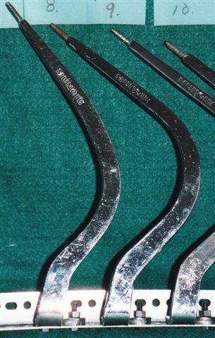

Default Re: correct shifter for my bucket non console car?
The handle on the left is the '69 bucket non console handle. It was also used for the 3-speed. See attachment!

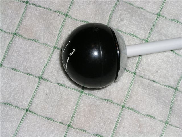

two piece knob see attached!
another see attached!
Thanks Dave, very cool...I never saw one of those or maybe I just wasn't paying attention!
