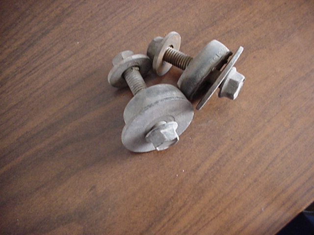

It appears that I am missing something here. Looks like this bracket is missing the cushion/bushing and hardware to mount to the core support. Does anyone sell this stuff? Anyone with a 70 Camaro that can shoot a pic of this area so I can see the hardware.

The assembly looks much like the core support bushings.
Unfortunately the main bushing with the built in washer is not made or reproduced. The other bushing without a washer that slips over the other bushing is still made my GM. I can't remember the part number but I think it ends in 159 or somthing like that.
The bolt and nut you can get anywhere. I have seen people use radiator support bushings from 67-69 Camaros.
I'll try to find the parts you need when I get home this weekend.

Darren, I looked through my many pics and could not find one showing the detail you need.
I thumbed through the 70 assy manual. Sec 11/13 sheet B4 shows all the parts you are missing.
www.amkproducts.com should have all the correct looking fasteners.
Rick's guidance on the bushings I have to assume is correct as he is very knowledgeable with 70 Camaros.
