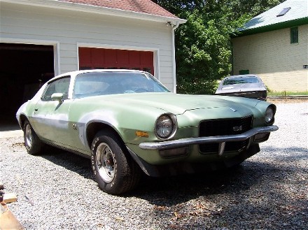

I'm looking at buying a 70 L-78 Camaro from a friend who has had the car for 10 -20 years. It has been in his garage ever since he bought it and he calls it in rough condition. I've seen much worse in fact my 70 Z started in worse condition before the resto.
I've gone through all the numbers and date codes match (M-21 trans with vin, dist, alt, heads, rear, exhaust manifolds, intake, water pump, intake and starter. It even has the COPO 3 peice spoiler.
My question is the engine block has a CKO code. From what I've researched so far the L-78's with a manual trans were coded with a CJH. I see that CKO is for a 396 with mt but doesn't specify a L-78. Would they have used the CKO block for a L-78? I haven't been able to find the vin on the block yet.
He is pulling all the documentation that he has for the car and he states that he has the POP but no build sheet. I hope to see the documentation soon and see what is there.
Also, any recommendations on what esle I should look for?
Attachments - The Supercar Registry 174699-70L-78InvoiceandWarrantyTransfer.pdf 167553-Web70L78Camaro3.jpg 167550-Web70L78Camaro2.jpg 167548-Web70L78Camaro1.jpg

CKO is the correct code for the 402/375HP Man. Trans. L-78.
What's the Prefix & date stamp on the Pass. side Rearend axle tube?
Please share pix of every single possible piece of documentaion with us,as well as the Cowl tag info.

Here are the pics I have so far. I don't have a pic of the cowl tag yet but here is the info.
ST 70 12487 NOR270003BDY
TR 723 45 G PNT
04C L78
Yes, it is triple green.
Thanks for the help.
