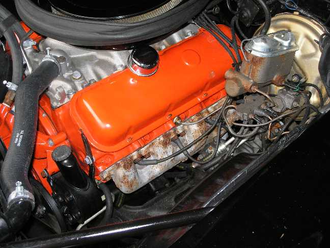

The L88 head was also made in steel as a parts replacement item.
If you went to the parts counter at a Chevy dealer and ordered an L88 long block, it would come with the steel heads. I have a CE stamped 512 block, and on the inside of the head is stamped L88.
The casting # for these heads is not listed in all of the Chevy parts books, like Colvin's.

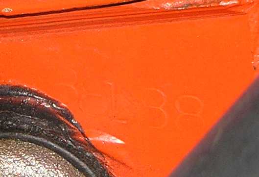

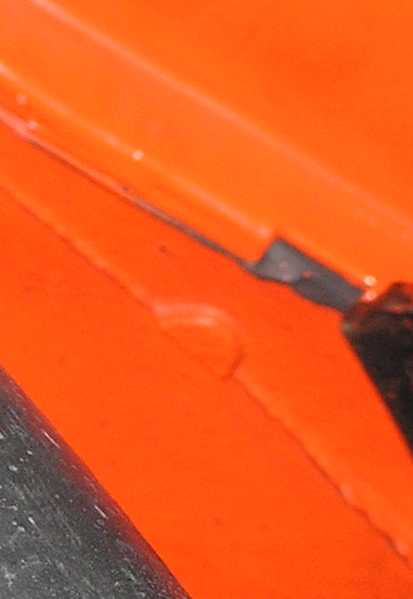

Steve, I wish I had taken photos of the casting numbers when the covers were off. The "HI PERF" is there, and the dates are March and April of '69.
They also have the "half moon" casting mark, indicating a closed chamber, square port application.
Difference between them is the amount of grin on your face at WOT.

Here is the casting mark.
