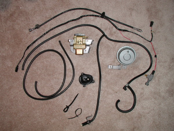

hey guys i just got back from a local swap meet and picked up a box of 67-68 camaro parts and inside was pieces for a cruise control unit mixed in with the other parts, would anyone have some pictures of an original unit?? so i could compare?? i have the under-hood parts, thanks dave.

Heres a 67 setup. I think it's everything except the blinker arm, and possibly some linkage pieces.

thanks guys, my parts look a little different maybe 69???

Mark,
I don't think that setup is correct for a 67. The speedo cable is wrong. The 67 and 68 screw into the back of the guage and the one you show is a 69 and up model that plugs into the guage. Also the vacuum can on a 67 has 2 hose connections and a special angled bracket with a roller.
I am not sure what wear yours is maybe a 69 or 70.
