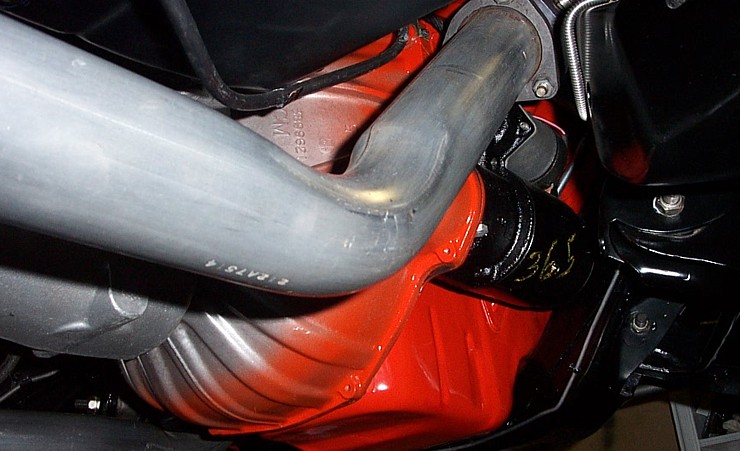

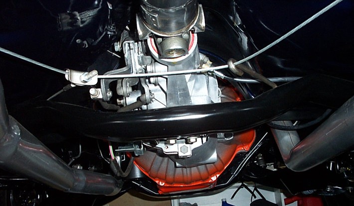

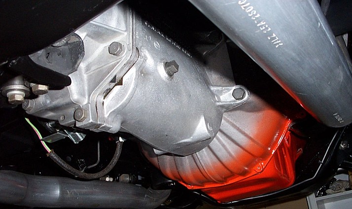

Here's a shot of a restored hsg....I just copied what was there.....

Thanks..just what I needed..I assume the bolts get painted as well? as if it were mounted on the block? thanks alot.

Yep,bolts and all.That's why the hsg was painted.It was in line of fire of the spray gun.
