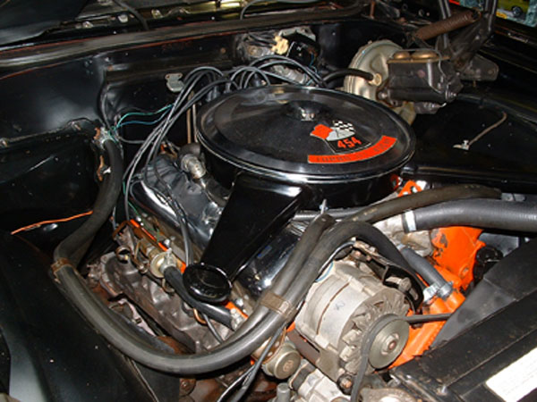

Jim,
Mine is Black; probably around an 80% gloss. Not a real good shot, but maybe this will help.
Rick, I know you're here; Speak Up! [img]/ubbthreads/images/graemlins/worship.gif[/img]
Dennis

Dennis,
I think he's inquiring about the part that mounts on the inside of the firewall [img]/ubbthreads/images/graemlins/blush.gif[/img] Probably called an 'air diffuser' or some technical name like that.

Jim,
The box has a slightly textured flatter black look to them. On survivor cars I have seen it is very dull and slightly textured almost like a 'dry' spray. That is how I restore them.
With regards to the firewall side, I think they are originally even glossier than 80%. On low mileage cars, flip the cover over and you can see that they are very gloss, closer to 90-95%.
Rick N.

Default Re: Heater Box 1970 Chevelle
Agree Rick, the Novas are the same way - dry, dull textured black on the inside box, glossy on the engine side - probably the glossiest black part under the hood!
Oops, my mistake. [img]/ubbthreads/images/graemlins/blush.gif[/img] You're right about the "textured" finish on the inside piece. I probably have a shot of that too, and will get it to you soon. Sorry for the screw-up.
