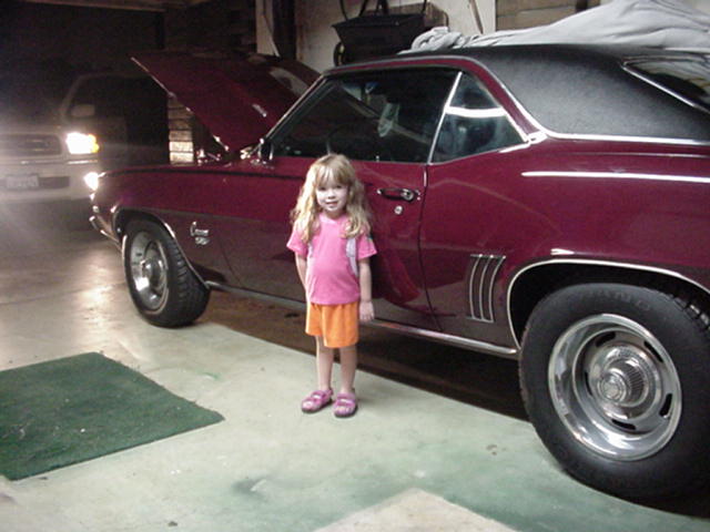

Mine is a repo. I believe I bought it in 1991. I am pretty happy with the way it fits. Here is a front end shot. Nevermind the kid. I can snap close ups and post if you like?

Looks like you got a good fit, from the pictures. The repro Endura and repro brackets need a bit of work to fit as good as original pieces.
The repro center brackets do not have the correct bend as provided by the factory and the outside bracket/ bushings tend to push the bumper farther away from the fender than the originals (almost 1/2 inch).
A bit of fitting prior to painting is recommended.

Darren, I appreciate your information about the bumper. I could not pass up a response to your picture without sending one of my own .
