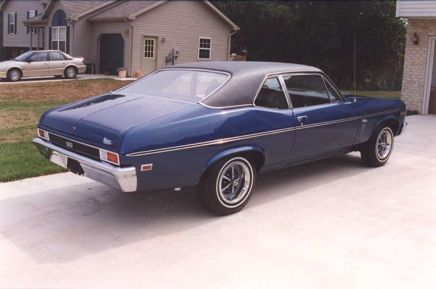

What correct BLACK (flat/semi/gloss)should the following be:
Rear axle housing?
Rear drums?
Rear springs?
Rear (and front) shocks?
Gas tank?
Gas tank straps?
Thanks!
Martin

My original gas tank was blacked out per the assembly manual after is was installed. The idea was to black out what could be seen from behind or the side of the car. So the AM shows the rear (as installed), sides, and part of the bottom painted. Greg

You mean this beautiful car [img]/ubbthreads/images/icons/grin.gif[/img]
