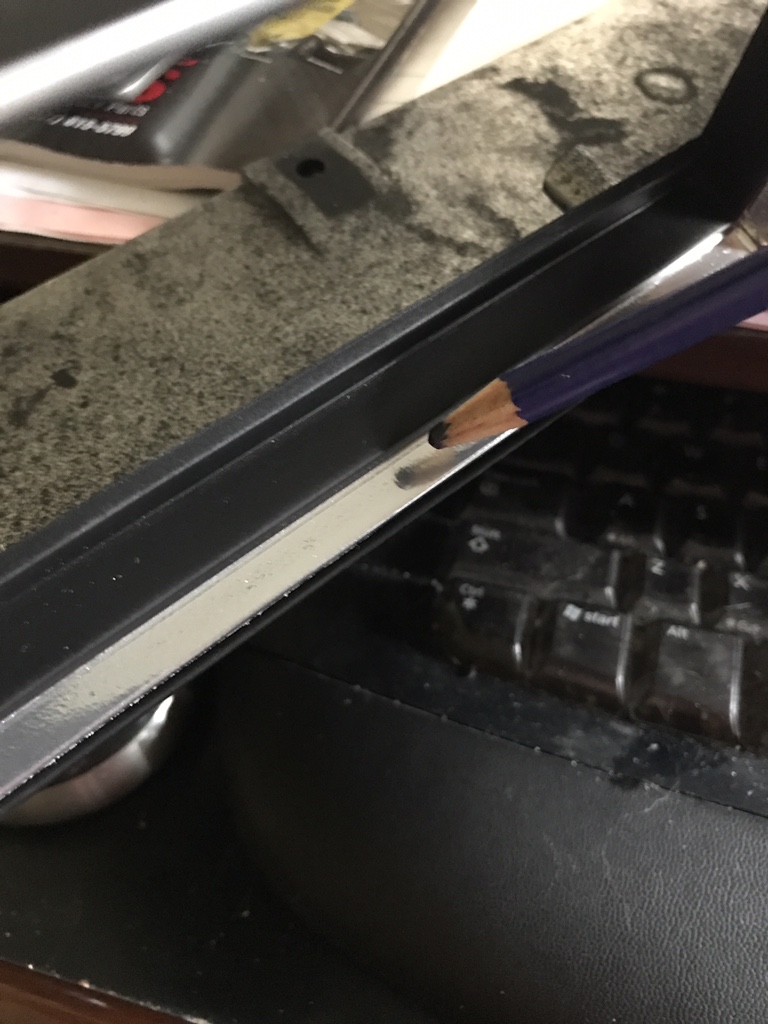

I use the Molotow Liquid Chrome 2mm Paint Pen to highlight the horn shrouds and dash housings, you can buy it at hobby lobby, amazon etc, you can also spray this with a small air brush. I have a friend who also builds models & paints the bumpers chrome.

I see from your first post that you are looking at paint. I used the Molotow stuff on my dash trim, but it isn't supposed to have a highly reflective "chrome" finish anyway, but more of a glossy matte, so it worked well for me. I did mine with an airbrush and then followed with a clear lacquer for protection. It turned out well for me, but again, I didn't want a high reflective finish like most dashes have.

This is what I have used for years. When applied following the instructions to the letter it dries looking very much like chrome and similar to what Dave described above, this product is not a full reflection like chrome but a very nice replication of the original. I also clear mine using their product upon completion. Pretty straight forward and simple affair unless you are doing a dash like this 70 Chevelle as it requires a LOT of masking after you have painted the face of the dash in chrome. I use the Molotow pen to paint the lettering and it too works great. Click the link below and be sure to use the black base coat and the clear finish coat.
https://spazstix.com/collections/ultimate-mirror-chrome
