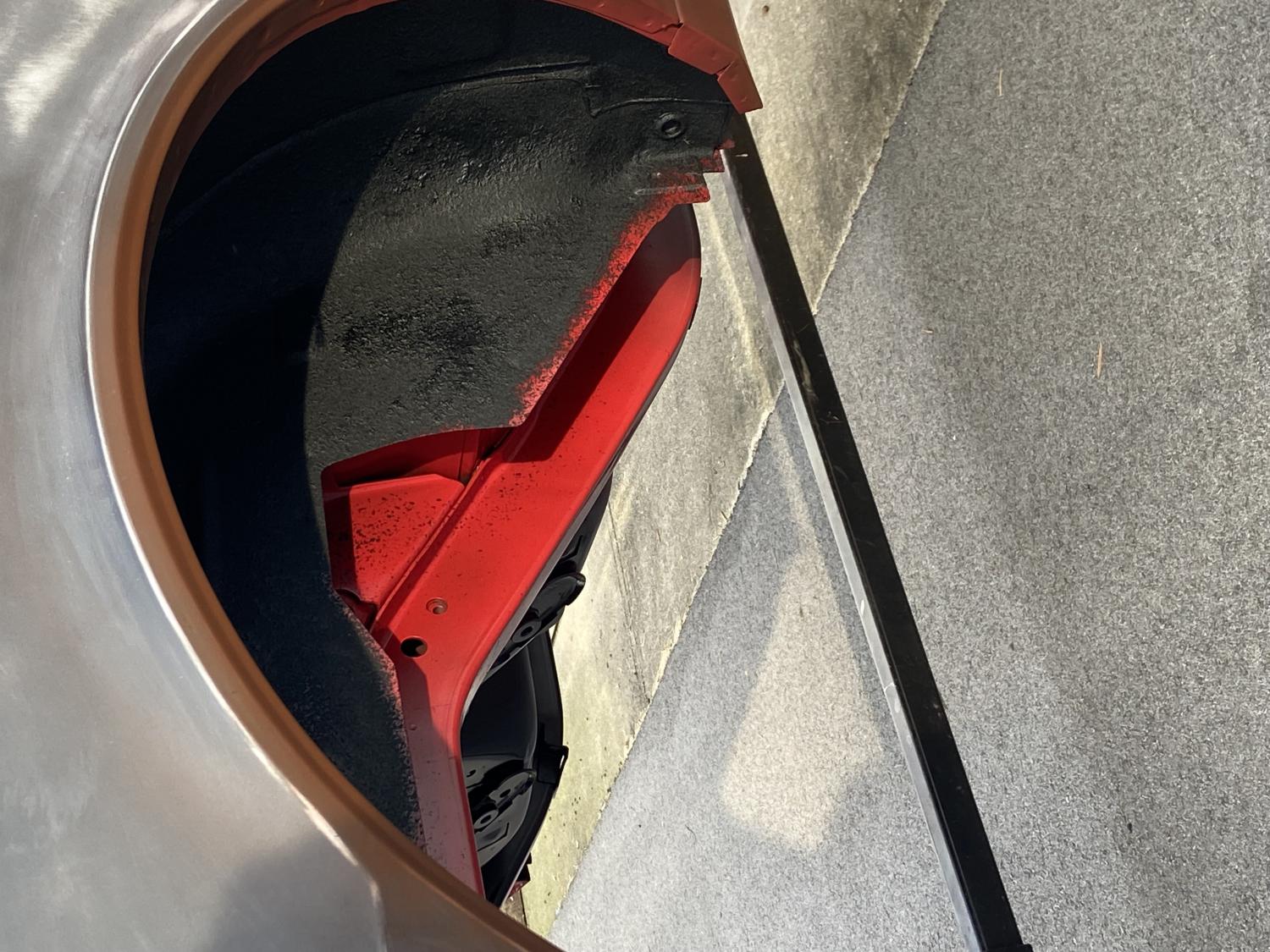

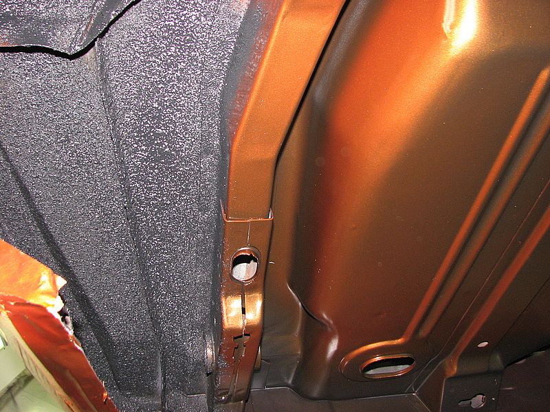

What is the best way to duplicate the factory undercoating in the wheel wells?

3M Body Schutz.

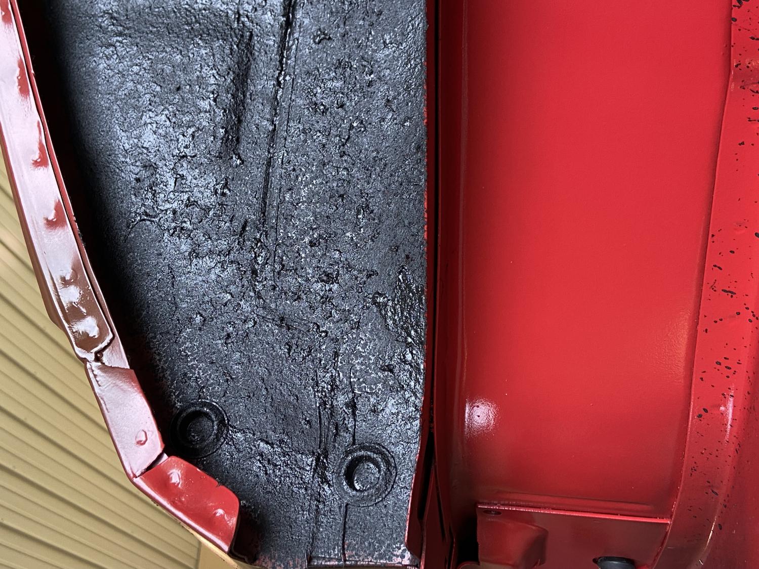

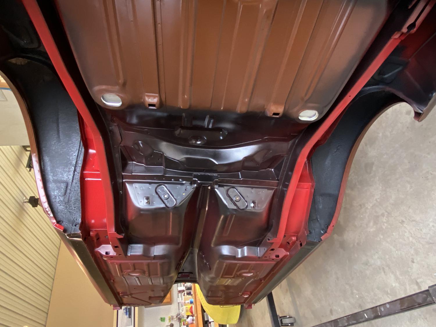

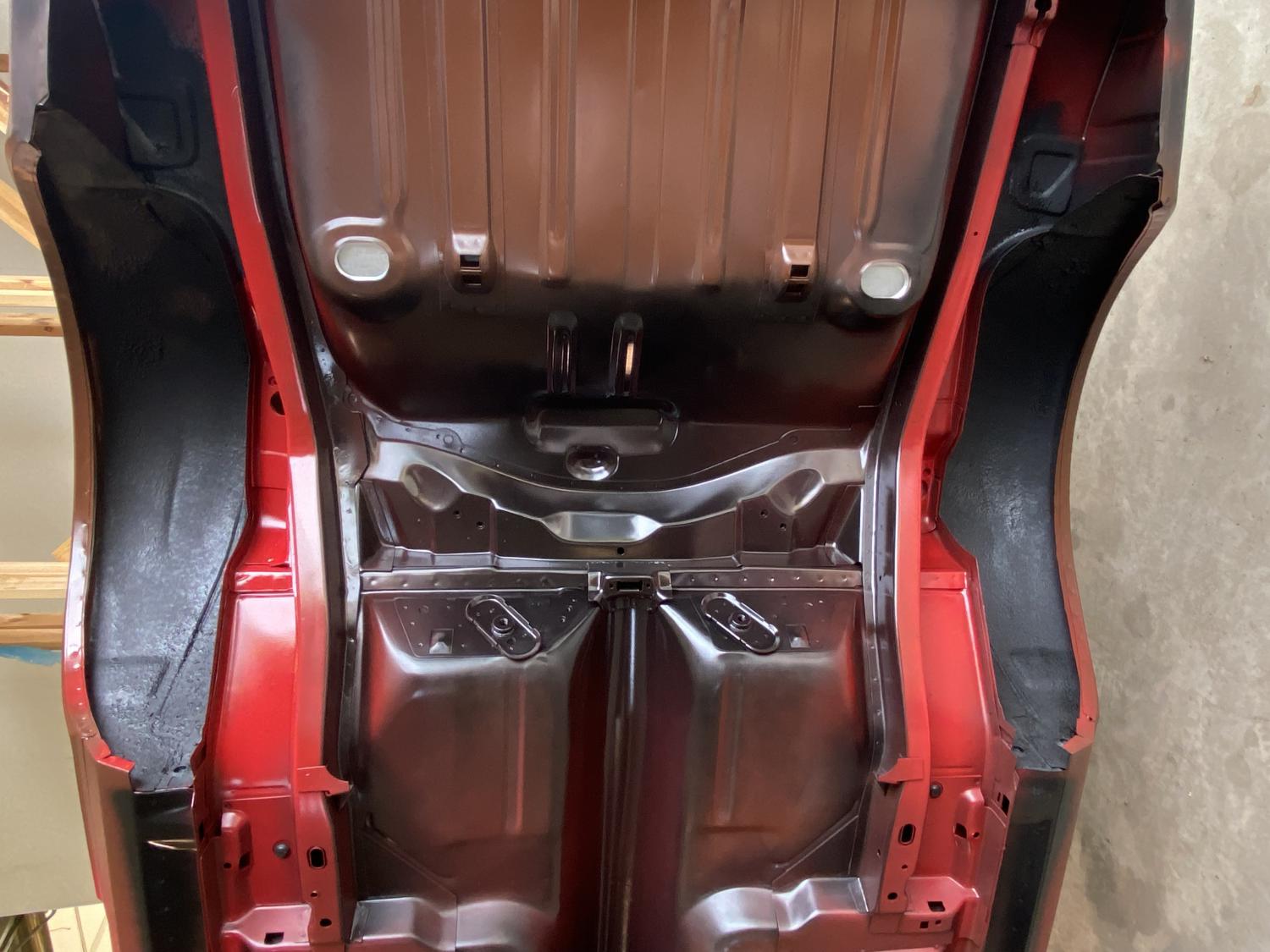

I shot these with a Shutz gun at 20 psi and 3M 08864.

I use a 3M product 08804 with their gun. Fairly inexpensive but takes a little practice with air pressure and overspray as it likes to go beyond where you are pointing so I used a piece of cardboard way out in front of the gun to limit this. In the end, it was worth the results.

That looks very good.

My experience with either of the 2 3m products mentioned is adjusting the air pressure and distance can get the wide globules to somewhat replicate the original tar based undercoating but when you get the width, it's too flat. I use a shutz gun and UPOL bedliner in black. It can give you the body to build and widen the texture, and it comes in quart bottles, but I believe you have to buy a gallon which of course give you 4 bottles. It does cure much harder than the 3m. You could top the UPOL with 3m and get a bit closer to the OEM appearance.
