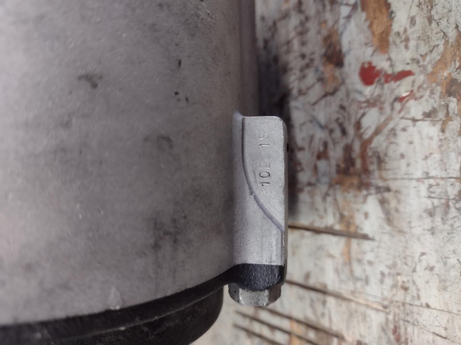

This is the smog pump from my 73 Z28. No idea if it's original or not. The stamping reads 10231S....the 3 is barely visible, but it's there. Anyone have a clue what the stamping deciphers to?

102nd day of 1973. Thursday, April 12th. Does that fit with your car?....Joe

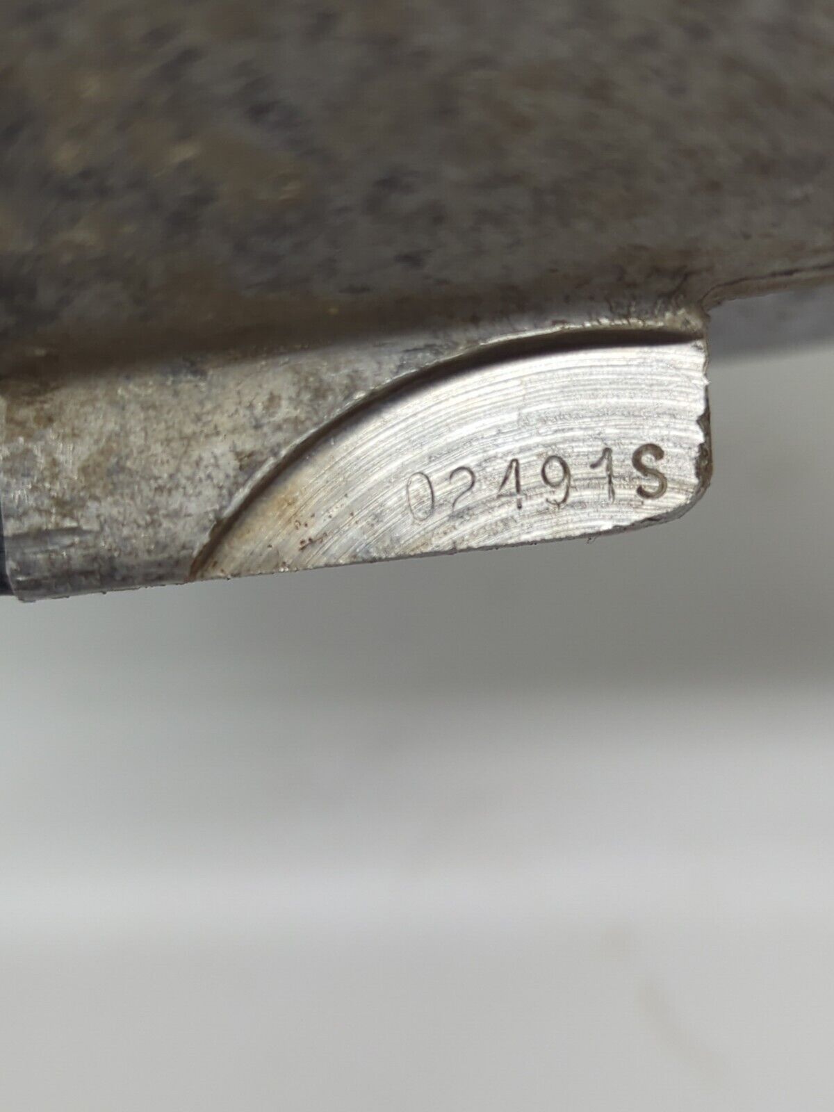

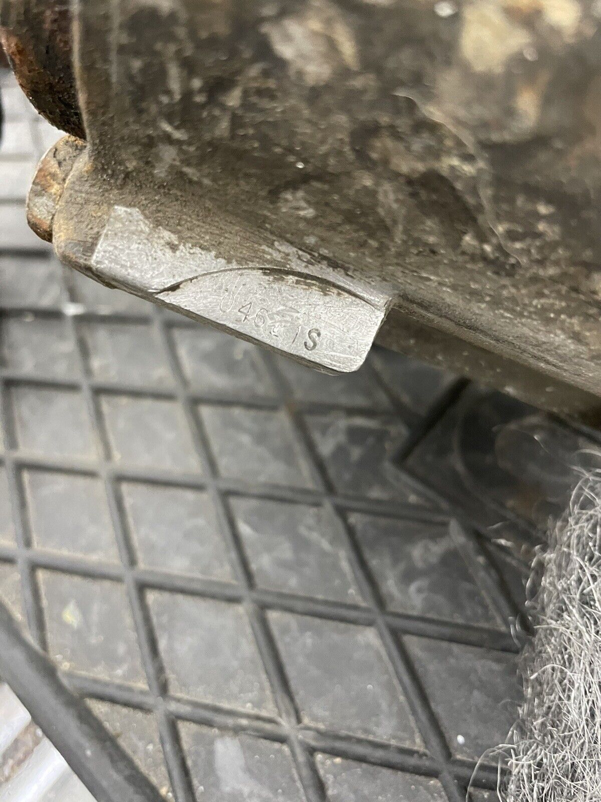

Alwas thought the"1S" suffix meant Chevrolet?
Pic 1 is Jan 24 1969
Pic 2 is 46th day of 1972
Could be. Obviously both of yours have that, mine has it, and one that was just sold on this site also has it. Thanks for the pics, Dave

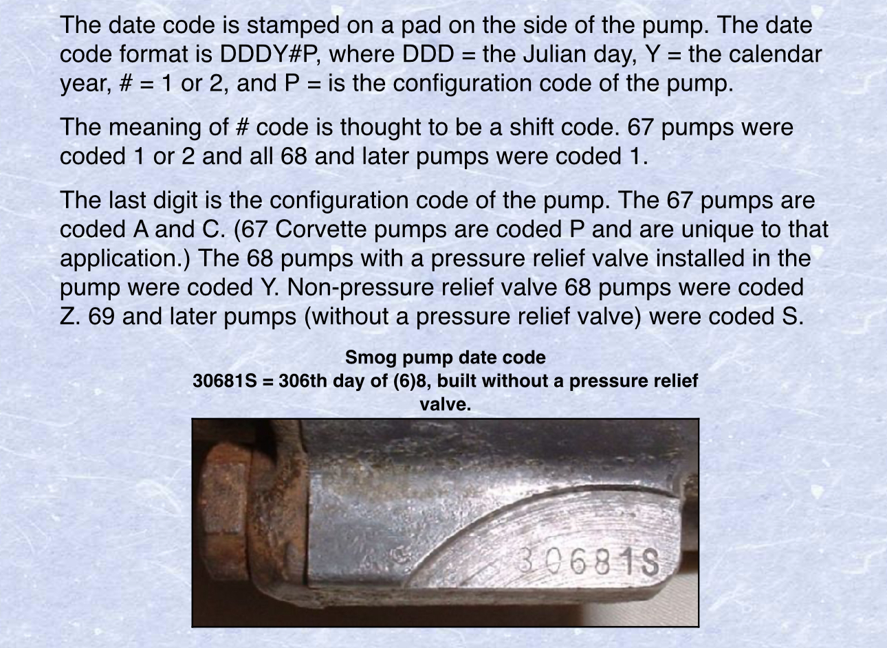

Default Date code breakdown
Per CRG:
