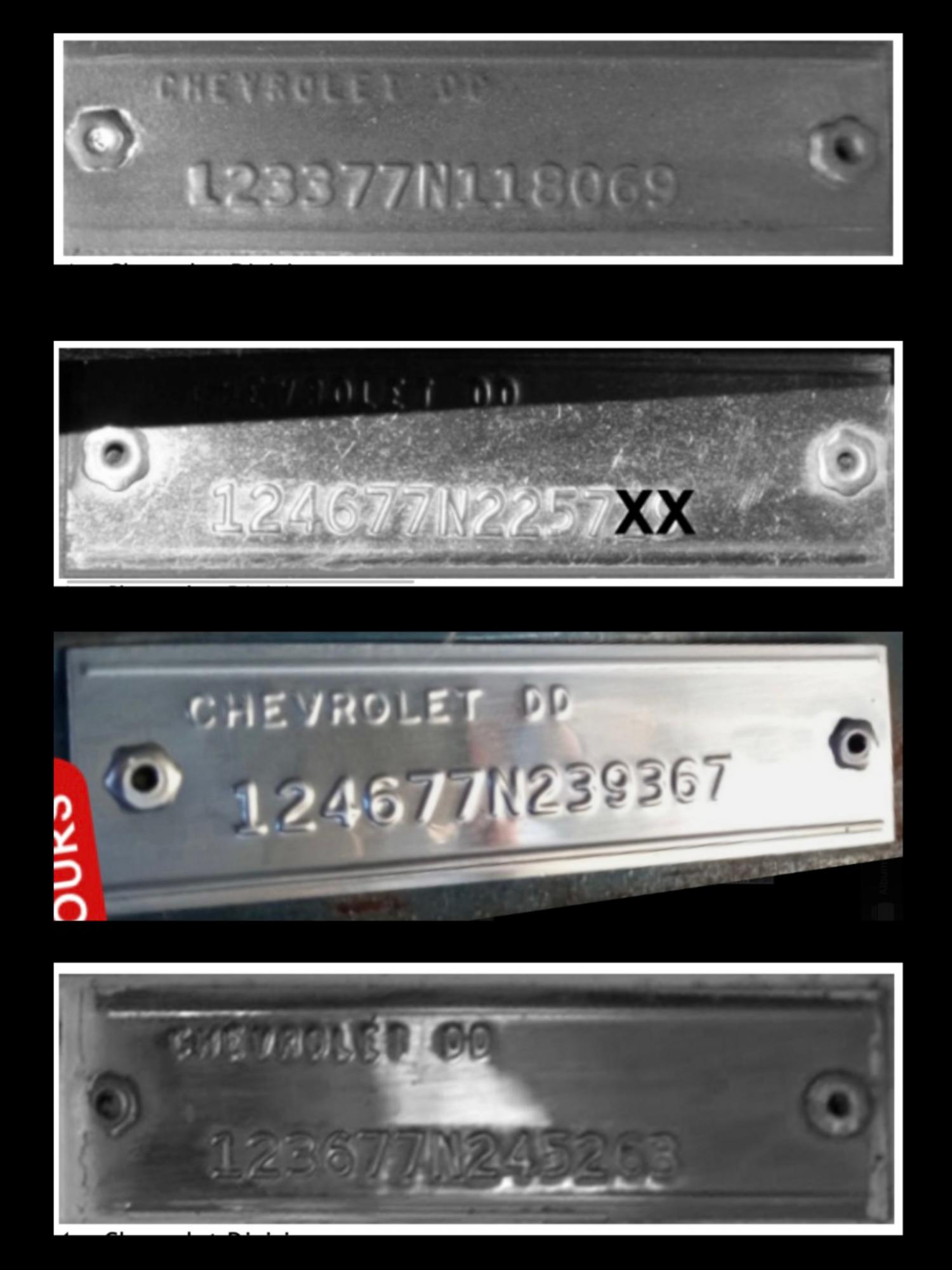

https://www.ebay.com/itm/26709036047...=10001&mkevt=1
Missing trim tag, and a VIN tag and rivets that look WAY fresher than the door jamb they are attached to.
Any way to tell for sure if that is a repro tag? I notice it has the fat/wide, round O in CHEVROLET (rather than the narrower more oval shaped one). Which is correct for Norwood in 67?
