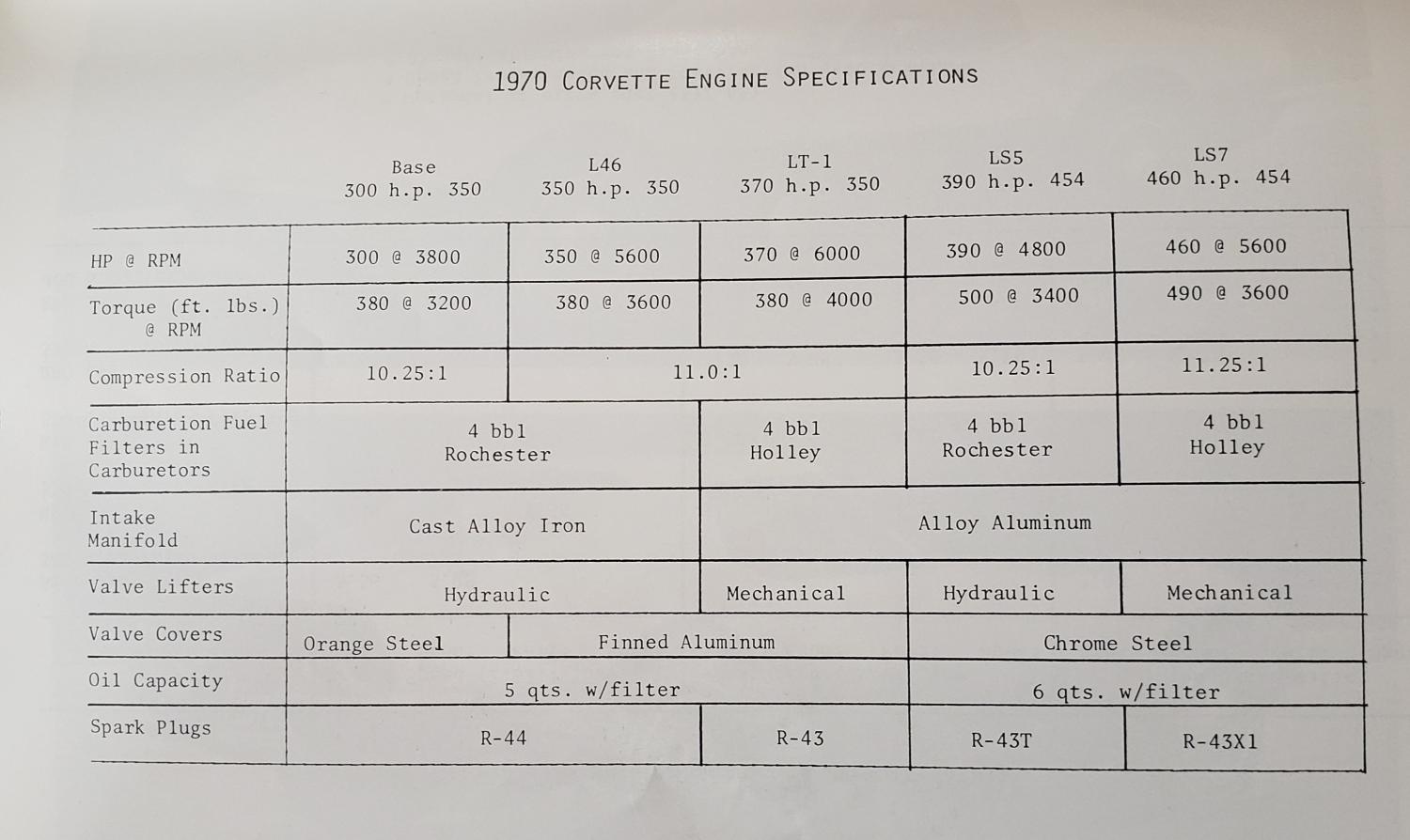

Hi gents,
I'm helping out a friend with a few projects on his 70 Vette. Right now he has aftermarket aluminum valve covers on it.
I've searched on line a bit and would like to know definitively if it has the finned aluminum valve covers or stamped steel covers painted orange.
Thanks.

Default Valve covers
From MF Dobbins book.

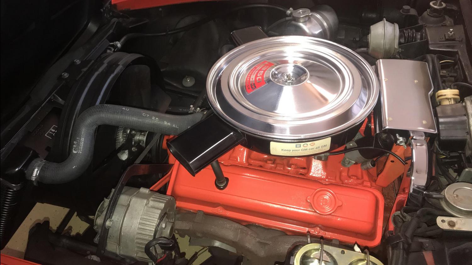

I have that car with that engine for sale in the for sale section. There's a good engine shot for you to see what a 17,500 mile car looks like.
Beautiful car! Wow!
