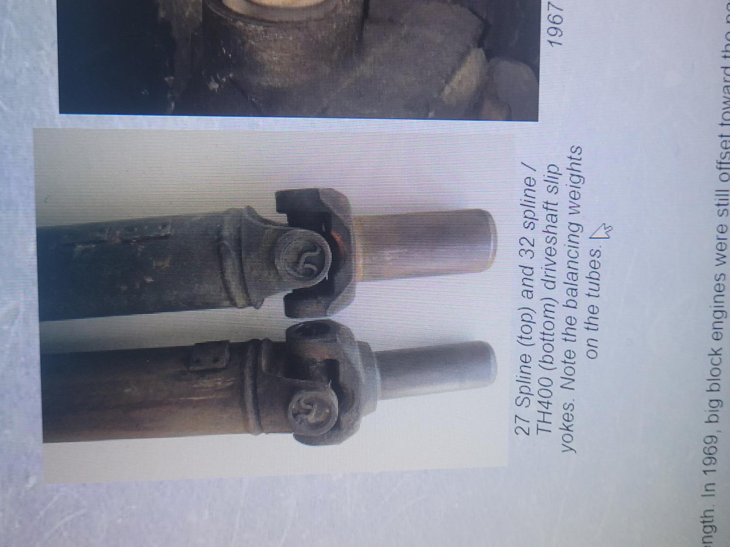

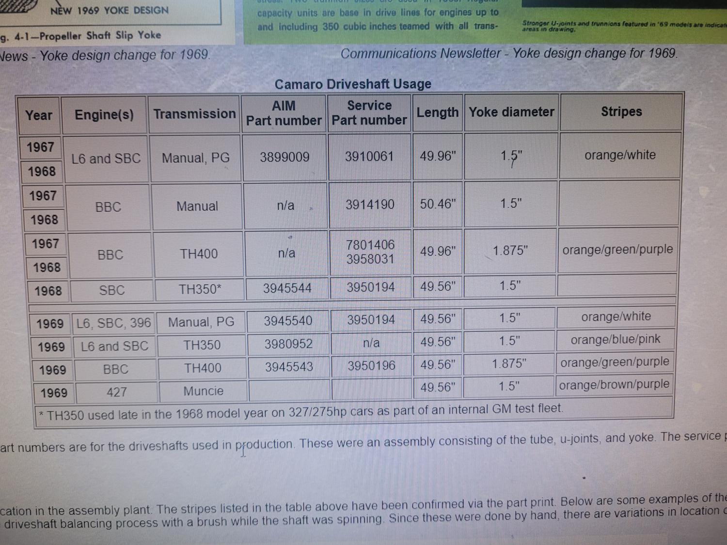

Here are some pi tures from CRG website. 1969 400 yoke is 1 and 7/8 diameter.

The 67 68 ujoint had the nylon injected retainers but the 69 400 yoke was set up for external snap rings.
