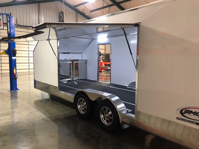

I had a 24' ATC and replaced it with a 22' Jimglo. It was 1000lbs lighter and I tow it with a 1/2 ton Ford Raptor with ease. The body is a honeycomb composite. Built in a prison by prisoners in Arizona. No seams as each side are one piece. Roof can be walked on. Expensive but very well built.
https://www.jimglo.com/
