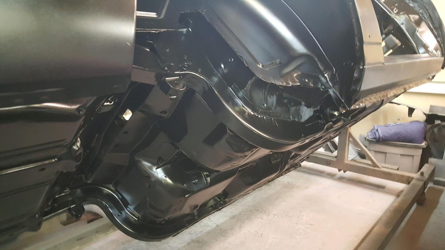

Default SPI Epoxy
Underfloor was done with SPI (Southern Polyurethane Inc) Black Epoxy
Notice the Sheen (Not Gloss by Semi Gloss)
Firewall Was Top Coated with DELFLEET Essential Single Stage Polyurethane mixed to the semi Gloss Formula
Chuck Sharin

MY above SPI underfloor not only looks GOOD but is catalized 2k EPOXY......What's the Quality of YOUR suggestion ????
