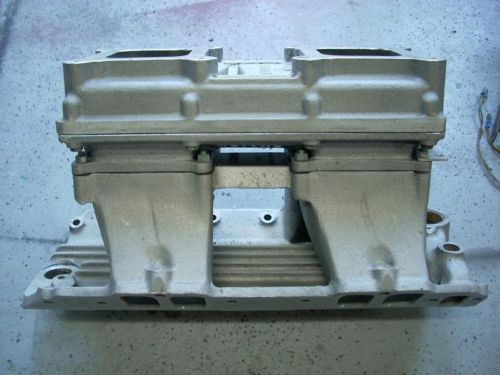

This is a cool intake. Only one I am aware of that has different port sizes per runner- see pic.

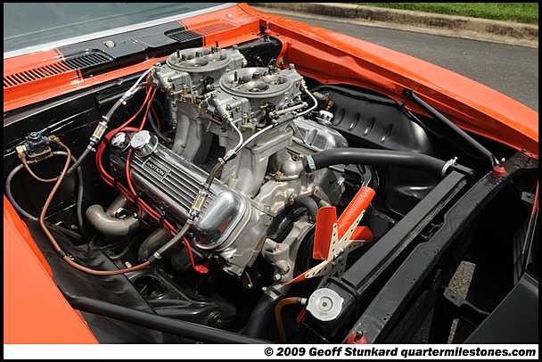

Here is the engine in my 289 Mustang- Offenhauser with 2 Holley 390's-the pre emission carbs w/o all the smog junk on them.Disregard the date on the photo-it was not set the day I photographed it.

Your engine looks great.
Does anyone know the time frame on the two pictured?

1974 ish...
