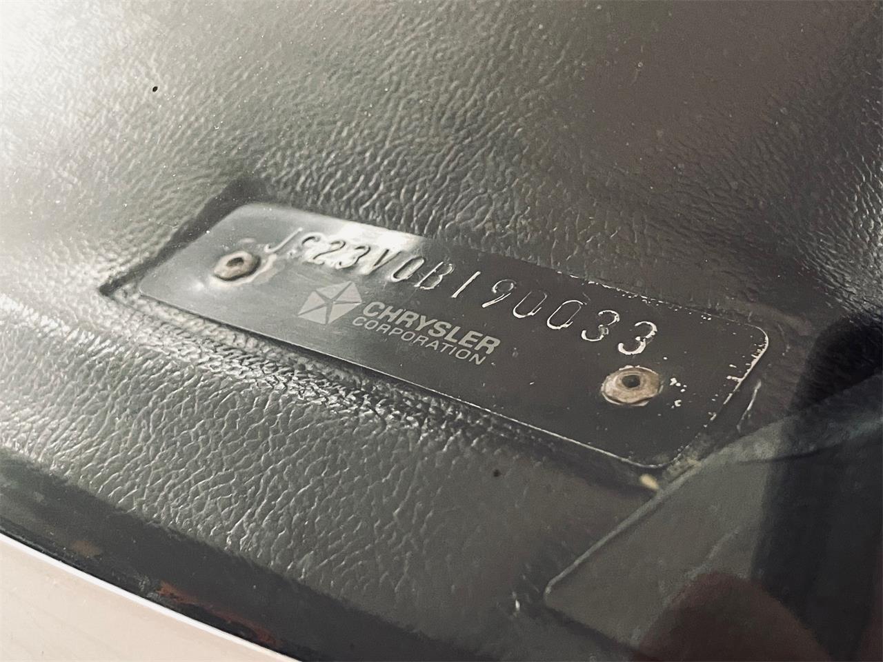

No Mopar expert by any means, but was that riveted VIN plate messed with.?

VIN tag most likely was removed and reinstalled on the dashpad. Stupid design by Chrysler to attach a VIN plate to a piece of upholstery. You have to remove the VIN plate to replace or repair a cracked dashpad. They are correct rivets but they look to have "spun" and scratched the flat black paint of the tag. If you try to drill out the rivet - the drill catches it and spins it causing those scrathes. The correct rosette rivets are available.

Aren't the Mopar rosette rivets flat black?

The dash pad appears to have been dyed or re dyed. So I assume they removed the VIN plate to do same. It is a real 6 pack car as denoted on the VIN. I couldn't get a look at the engine, tranny and rear stamps due to the circumstances of not being able to get it out onto a lift or test drive it due to rainy weather. It is a very nice looking car and the engine sounds bad a$$...
