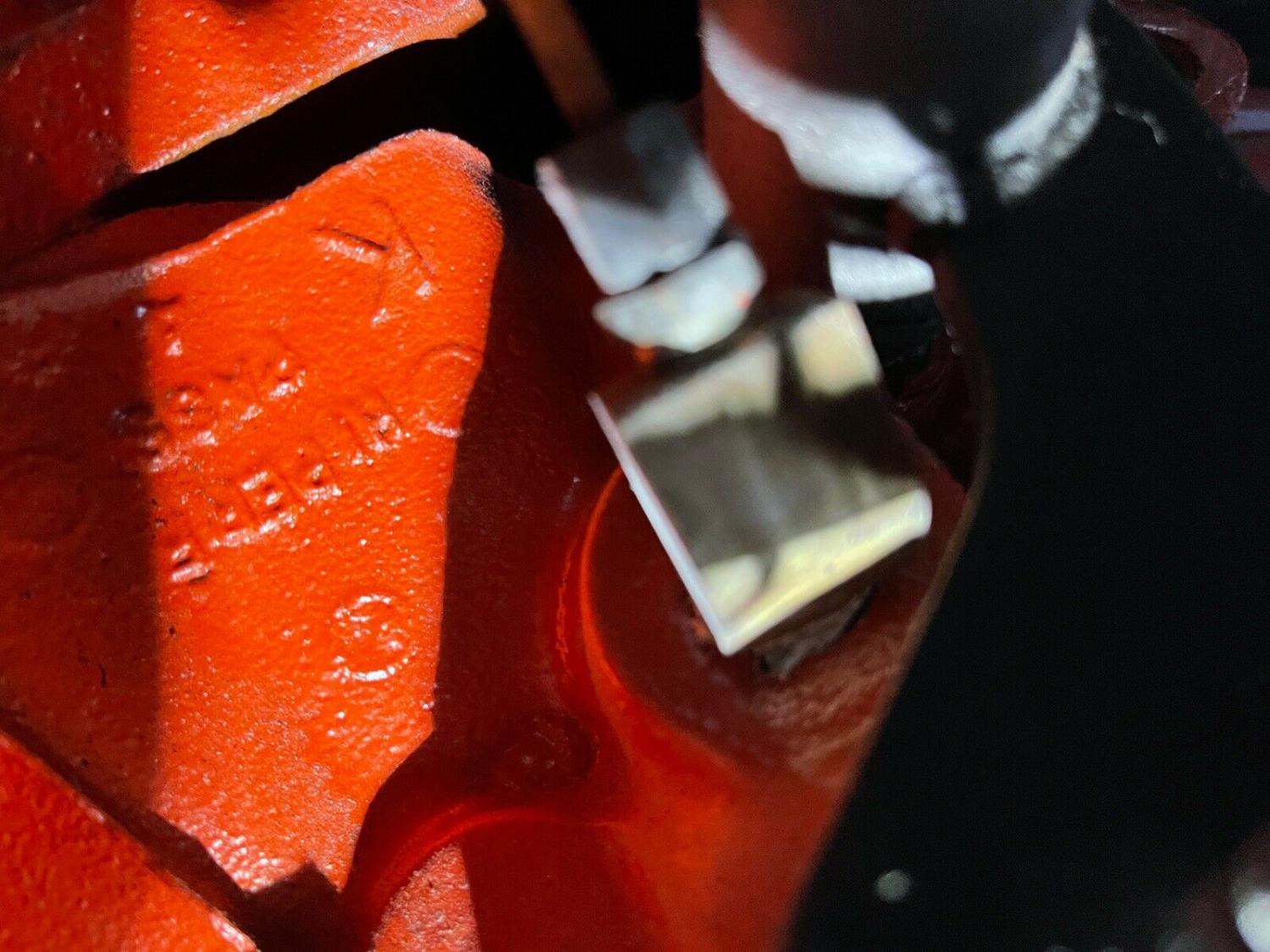

For searches -- 138177A166602
I asked the seller for pics of the oil line holes to verify what I already knew (I saw pics of this car several years ago, unless there is another white one with an L34 stamped EG). See below. 2 bolt main. So definitely not an L78 block.
Jeff Helms
