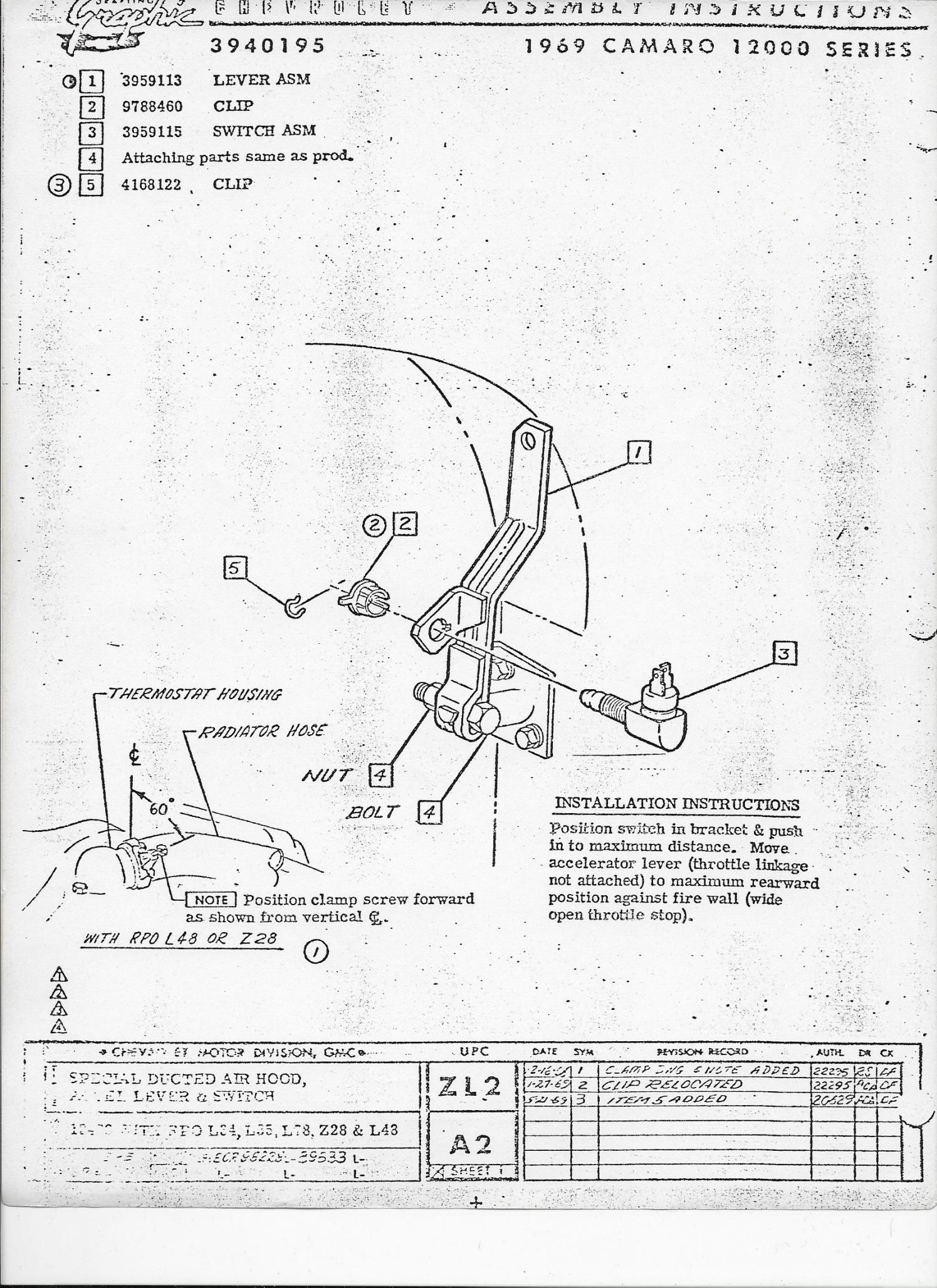

Do the instructions in AIM help? They're on ZL2 A2. I'll send you a picture when I get to the shop....Joe

Late last night I took a pair of tin snips to the retainer clip and slightly trimmed the opening for the switch. I havent tried it yet but plan on it.
I also think it helps to provide some pics so I will do that also.
I need to conquer this thing.
The next thing will be trying to replace my current non CI throttle arm with this one. My engine is in and it makes it hard to get access to that.
Joe, thanks for the pics you sent and your willingness to help out

Be sure after you install switch, you install the clip to hold the switch in its adjusted place when you go full throttle. The clip I am talking about is the same one used to hold the window cranks in place. If you do not install this clip after you get proper adjustment, when you go full throttle you will push the entire switch back towards the engine.
- Warren
Old 12-02-2020, 03:31 PM
WorkinProgress WorkinProgress is offline
Join Date: May 2012
Location: Constitution State
Posts: 506
Thanks: 38
Thanked 193 Times in 104 Posts
Assembly manual showing clip as number 5, as stated in my previous posting.
- Warren
