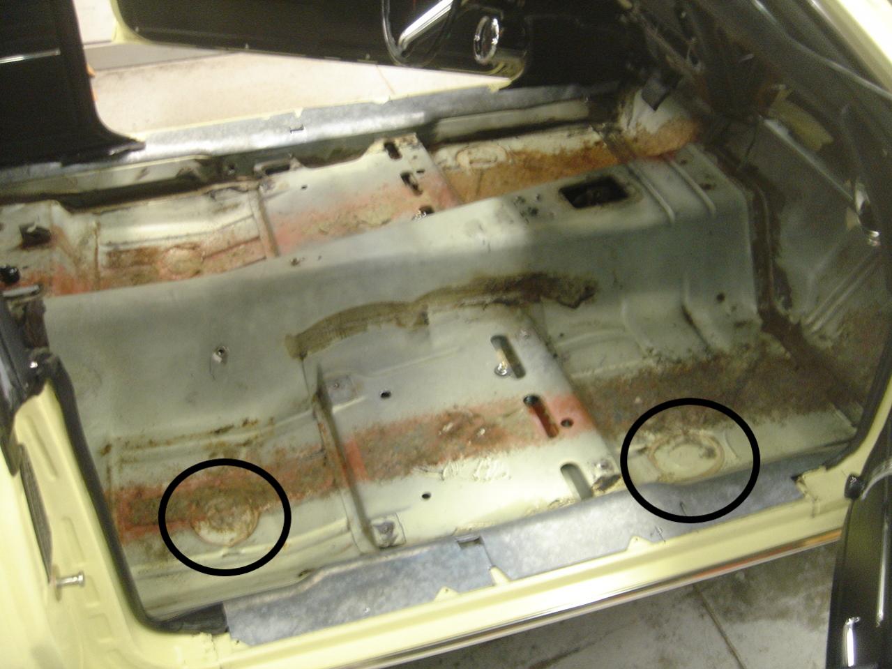

Default Oval Holes in Floor and Trunk
What is/was the reason for these holes with the covers? Thanks

Floor drains. In the dip primer process it was a drain point for the excess primer to drain out.
