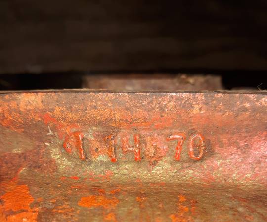

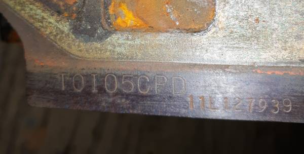

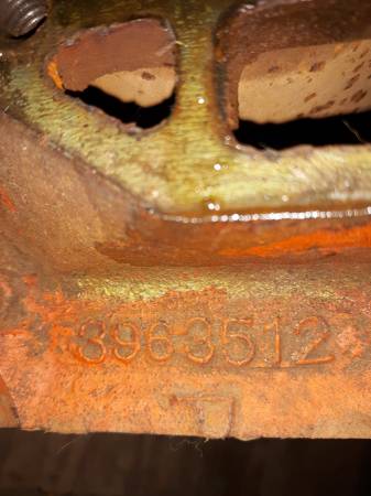

Did I decode this correctly?

CPD suffix does seem to decode as LS-5 in those models, 365 HP in '71 and 270 HP in '72 - that looks like it's dated / was destined for an early 1971 model. Cheers.

Also is 71-72 Impala and police with turbo 400
