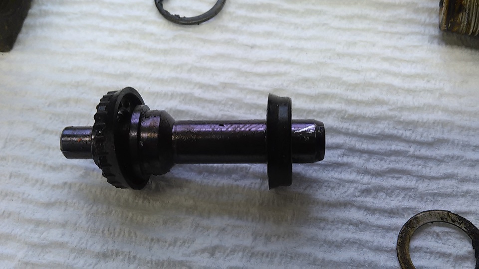

Has anybody had one of these apart that confirm the direction of the rubber boots? When I pulled the piston out, the boot popped out and landed on the bench and I'm not 100% sure which way to put it back together. The one on the left is the one I'm not sure of. Thanks

Here you go:
https://www.musclecarresearch.com/kh...-valve-autopsy

You got it. I’d recommend a new seal kit from the vendor in the link. Easy to rebuild.
