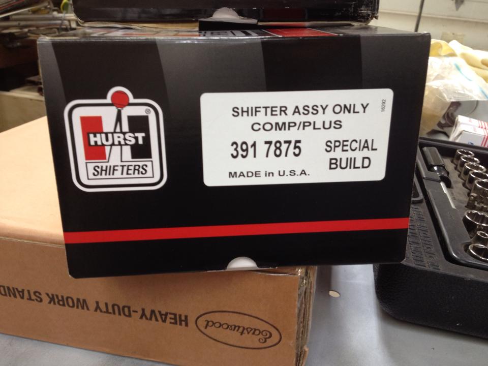

I want a hurst shifter to replace the factory Muncie shifter in my Nova. I did a few searches and found some good info. It appears I need a 1.5" offset to work with my console.
So I found this on ebay.
https://www.ebay.com/itm/1969-1970-C...53.m1438.l2649
I think it will work but the chrome stick also has a offset to it. Will it be too much offset?
Thanks for any advice.
Pete

The shifter listed in the catalog's won't work, if you have a '69 with a console you need this one - not listed in any catalog. I got mine from Jody Haag of Jody's Transmissions, fits perfect.
