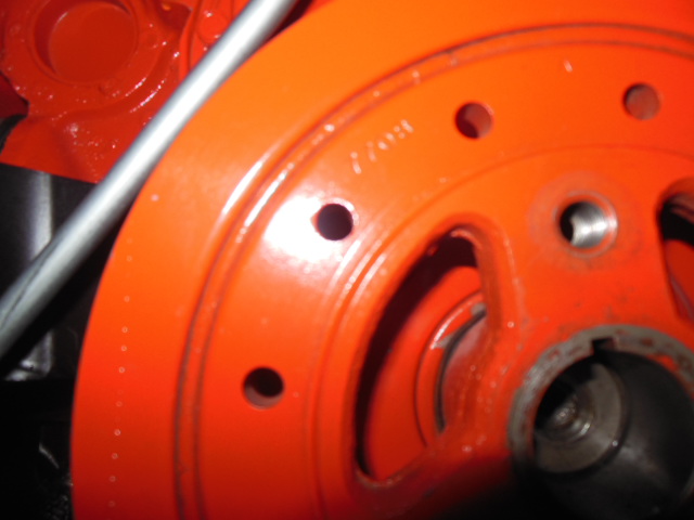

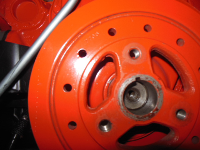

Is this the correct balancer for a 69 z/28 THE STAMPED #IS 7708
Attachments - The Supercar Registry DSCN7271.JPG DSCN7270.JPG DSCN7269.JPG 69 Z28 Assemblyline Balancer.jpg
Old 09-24-2019, 09:36 PM
Posts: 20,989
Thanked 3,661 Times in 1,479 Posts
Yes it is,part #3947708.

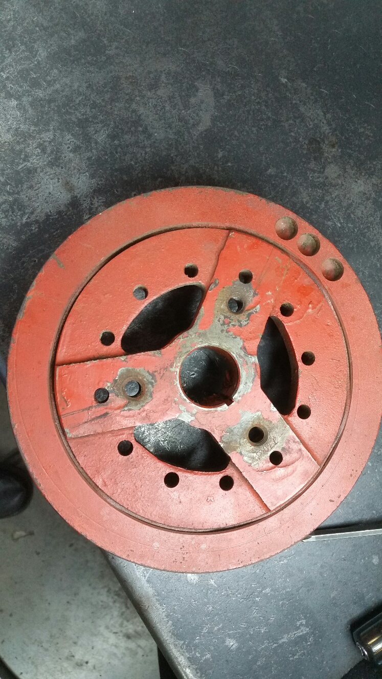

Yes it is, except it's not assembly line correct. If you are restoring a car to show or for correctness that is not the balancer to use. If you are building a driver and only functionality is necessary that will work. Correct assembly line balancer pictured below.

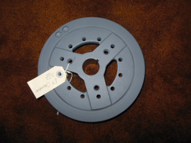

Old 09-24-2019, 11:49 PM
ALLZS ALLZS is offline
Join Date: Dec 2007
Location: ST LOUIS MO
Posts: 1,987
Thanked 126 Times in 69 Posts
Default balancer
ok I see the difference it should be like this one I have . thanks guys for all the help
Old 09-25-2019, 12:30 PM
ZLP955's Avatar
ZLP955 ZLP955 is offline
Join Date: Dec 2012
Location: Australia
Posts: 1,180
Thanks: 751
Thanked 254 Times in 183 Posts
Assembly line balancer should be stamped 7708M.

Old 09-25-2019, 01:21 PM
Join Date: Dec 2007
Posts: 1,987
yes the one I pictured has 7708M
Old 09-26-2019, 11:09 AM
ZLP955's Avatar
Join Date: Dec 2012
Location: Australia
Posts: 1,180
Thanks: 751
Can't make out the 'M', but assume that's on the grey balancer?
I have one stamped 7708E on my CE 302 and it is a later service replacement with the shorter fingers that don't extend out to the rubber.
