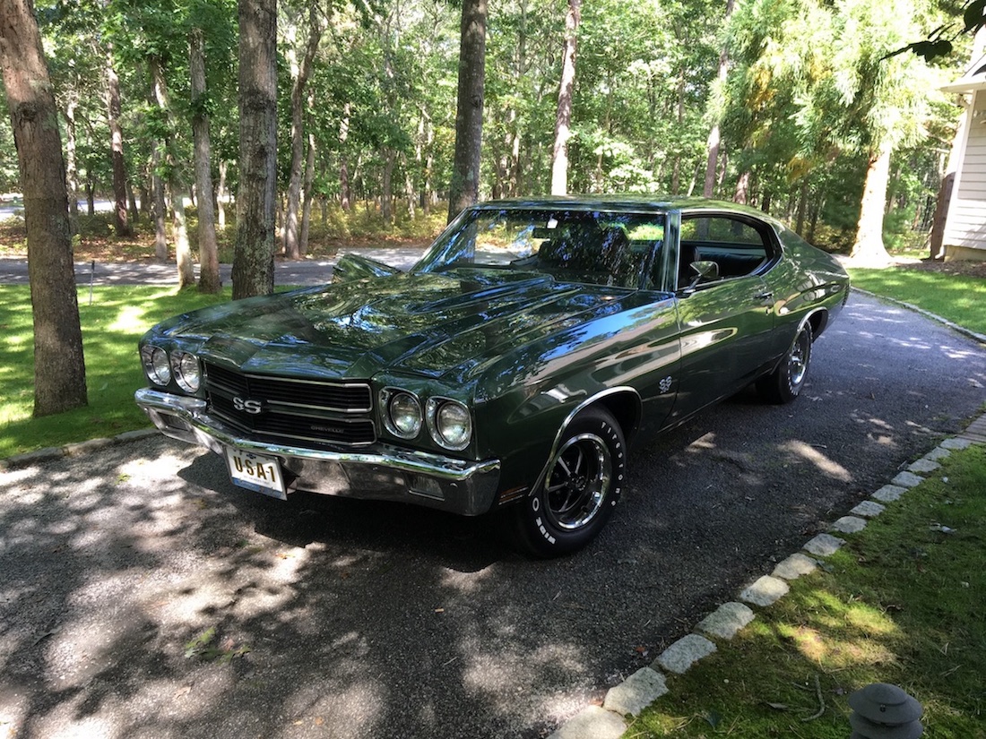

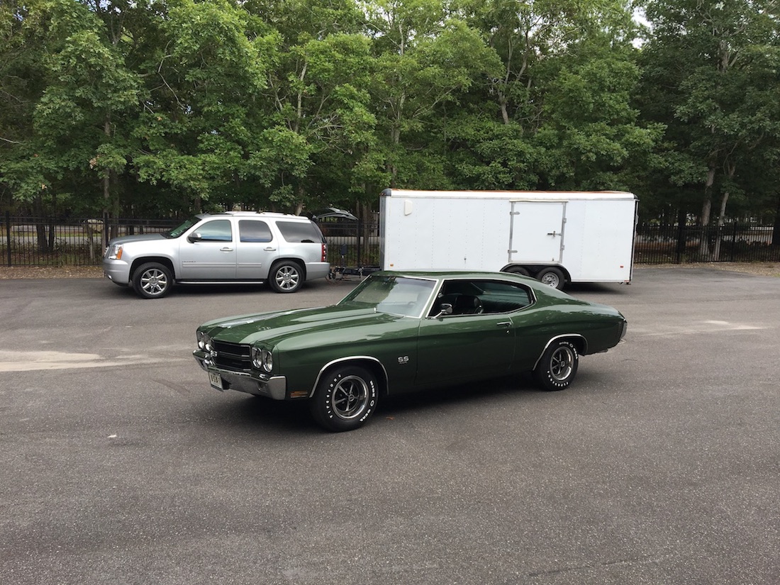

I put them on our LS6 Chevelle (will post pics later). The tire is a radial. Period. The only thing bias ply about it is the vanity. They’re wonder tires and ride like modern radials because they are modern radials. Only issue is that they don’t smoke well
