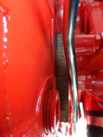

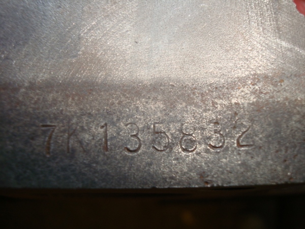

I'm looking at purchasing a L78 Chevelle just curious what every one's thoughts are on this stamp. I didn't know if anyone has a data base of pictures to compare it to? It looks good to me but I don't claim to be an expert and want a 2nd opinion because I will be paying up for the car. Thanks Andy

If you click on the link it shows a better quality pic. I had to downsize it a lot to get it to upload here

Being the 67 is relatively rare, it's hard to say. Compared to seveal 66 "EG" stamps I have the engine date/suffix looks right. The fonts for the KC partial VIN appear to be be correct when compared to other 67s from KC. Sequence 183434 is early May for KC so engine date (April 6) isn't too early for the car.

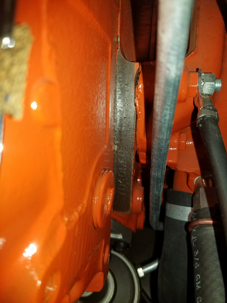

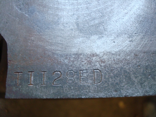

Here are pictures of the original stamping of my 67 Chevelle

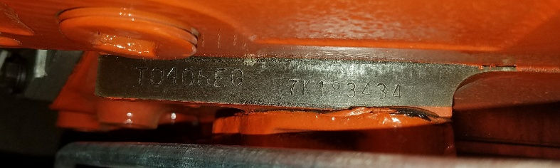

While I own 3 67 L 78's 2 are Baltimore cars and 1 is a Kansas car. Comparing my stamping to yours they look very close. My concern is why the broaching isn't under the stamped numbers? I see it back close to the head but it looks smooth under the stamping. I have found more cars that weren't real than one's that are. If I were buying this car I would be all over every thing checking dates. Does it have the big radiator?? That will cost you 5 grand if you find one the carb. the distributor these are very important L 78 only parts. Does it have any paper work very important to check all these things before you lay out the cash.
Not a real good picture of my Kansas stamp but maybe it will help.

On my high quality pic you can zoom in and see broach marks under the numbers but they are pretty faint. The pad was painted at one time some I'm assuming they might have been lightly sanded a little more in that area trying to get the paint up from the number? The pad is flat across not like someone erased a previous vin and restamped it. If it was restamped they did the whole thing. I just want some comparisons as far as fonts and spacing etc. and other peoples opinions before I close the deal.
