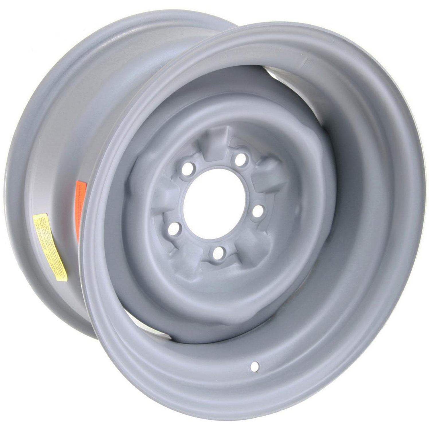

As luck would have it, the Vintique wheels listed here ( http://www.jegs.com/i/Wheel-Vintique...34044/10002/-1 ) are 15x7" and have a 4 1/4 backspace. Thanks Grady!

I bought a pair of the repro steel wheels a few years back. I did not notice that the center hole is over sized on the repro until I mounted the tires and put them on the car. It did not look right to me.
Which manufacturer did you buy Bill?
