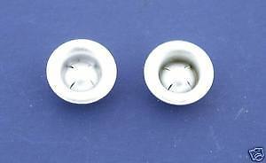

Those do not look like original rivets. Originals were punched through and spread out.
Those look like the replacements that have never been punched.
