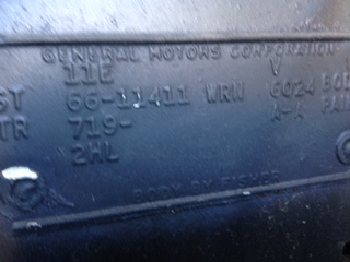

Here is a photo of a cowl tag on a 66 Nova. The car has had all interior stripped out on the inside. Trying to ID the correct color with the trim code but can not find it anywhere. It is trim 719. Pretty cool car otherwise. Thanks, Larry

The AA indicates a black car. Looks like a fawn interior ???
2HL is heater delete 4spd .... pretty rare piece.

I looked all over for that 719 and just couldn't turn up a definitive answer for it. Maybe have to look across the entire 66 / 67 vehicle line..

The V above the Fisher body number, if I recall correctly, is the interior paint code which in 1966 is fawn.

http://www.novaresource.org/c66.htm
This could Easley be a misprint and should be 718...not 719.

Does the dash after 719 have any meaning like a dash after a 67 camaro 4K?

There is no V listed for the 66 Nova interior sheetmetal color.

did gm let you pick interior colors that where not suggested. special interior?
