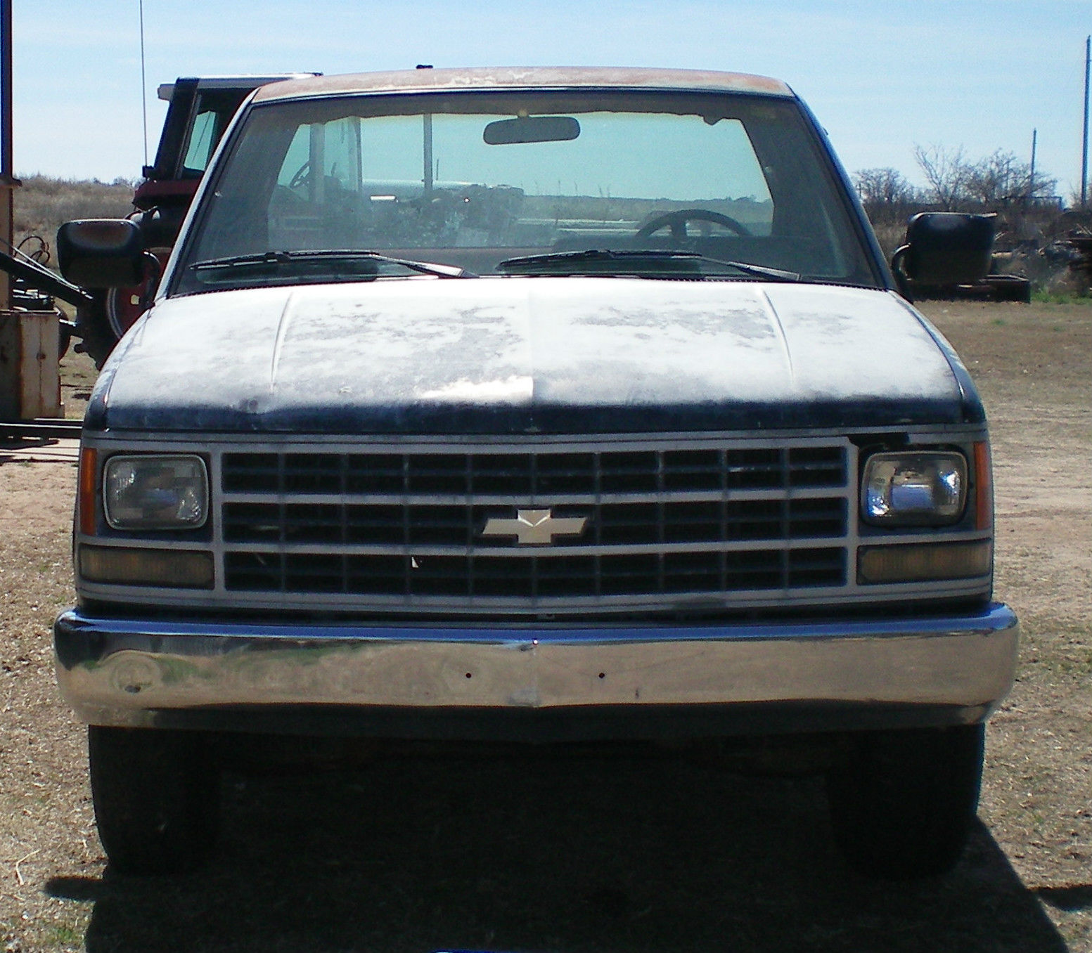

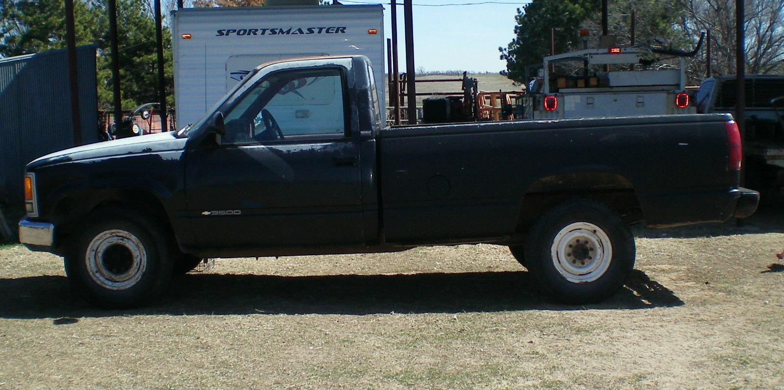

Here are pics of the potential donor (along with one of the Studebaker). It is a running, driving vehicle. I would go through the engine just because, but it already has a new clutch. Go through the brakes, get the A/C working and transplant my Studebaker cab and the dump bed (looks like a stake bed or flat bed). I have plenty of fab skills (after all I have a chop saw and two mig welders, which makes me a fabricator, right?) I know I will need to fab up some brackets and adapters to get the Studebaker stuff on the Chevy chassis.
I can get the “new” truck cheap enough. After cannibalizing the chassis, I can sell the bed and cab.
I have a couple questions for you truck guys. As you can see, this truck has the 8 lug wheels, but not dually wheels. If I am hauling a car, I would feel better with dually wheels in back. Can I just buy a set of 4 wheels and use this full floating rear? Fender clearance won’t be an issue, because I am going flat bed. I would rather not go looking for a complete rear end.
