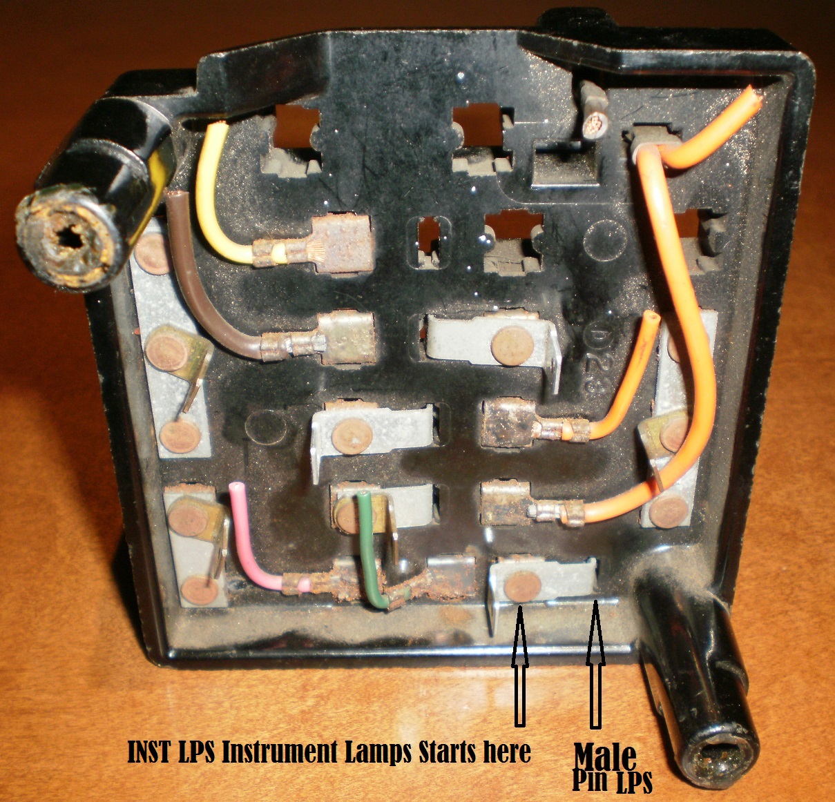

Does any reproduction company make the 1970 Chevelle CD2 Fiber Optic Washer Fluid Monitor Float with rod.
Below is a photo of my broken one beside a complete unit.
Or is there a person or company that can restore this.
Let me know.

I use to restore a lot of these when I still had my parts company. You can source the float from a craft company. Find a dense material similar and cut the float. Find something to use like a hole saw. You can cut a square shape and sand it also. The shaft can be made from a plastic rod. Get creative. Use a tree from a model car kit, a swizzle stick... Ect. You'll need to plastic weld a flat piece to the top and add the color with translucent paint. It's not too dificult, you have the hard part done, you have someting to copy.

I glued the 2 pieces back together and found a small piece of plastic that I had from a Pertronix kit (Used for spacing the magnet) Lucky I kept this spacer all these years. I shaped it and cut it like the original and the red paint is my wife's Nail polish and green paint I had in the garage. The glue I used is called &quot;The LAST GLUE&quot; I have repaired a lot of plastics with this stuff including dash parts, it works great. [img]<<GRAEMLIN_URL>>/biggthumpup.gif[/img]

More clean up, smoothed out the rod with the Dremmel tool.
Finished

What does the light look like that goes through the wife's nail polish?
There was a guy that was repopping the floats on Team Chevelle, but I don't know his contact info.
I bought a few of them from him when they were advertised as I have 3 cars that have this option.

67 442, that one would not be correct for 1970 as the top unit is black, 1970 was the same color as the bottle white/tan. Also the float is very different.
&quot;What does the light look like that goes through the wife's nail polish?&quot;
Hey Rick see this photo, I always liked candy apple red [img]<<GRAEMLIN_URL>>/biggthumpup.gif[/img]
