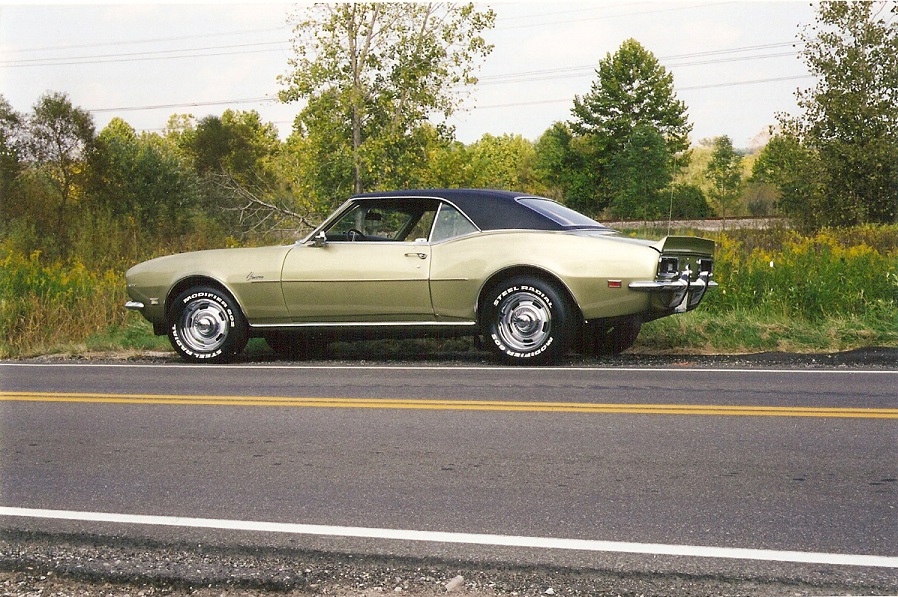

Here are two shots of the Camaro. 235/60 15 up front and 255/60 15 out back. Standard 15x7 wheels. You probably will hook better with the 255 out back. Stock suspension, and full wheel well lips. No issue at all, front or back. Car has power steering.
Happened to have a good side view of the tires with my wife taking it to a car show.
