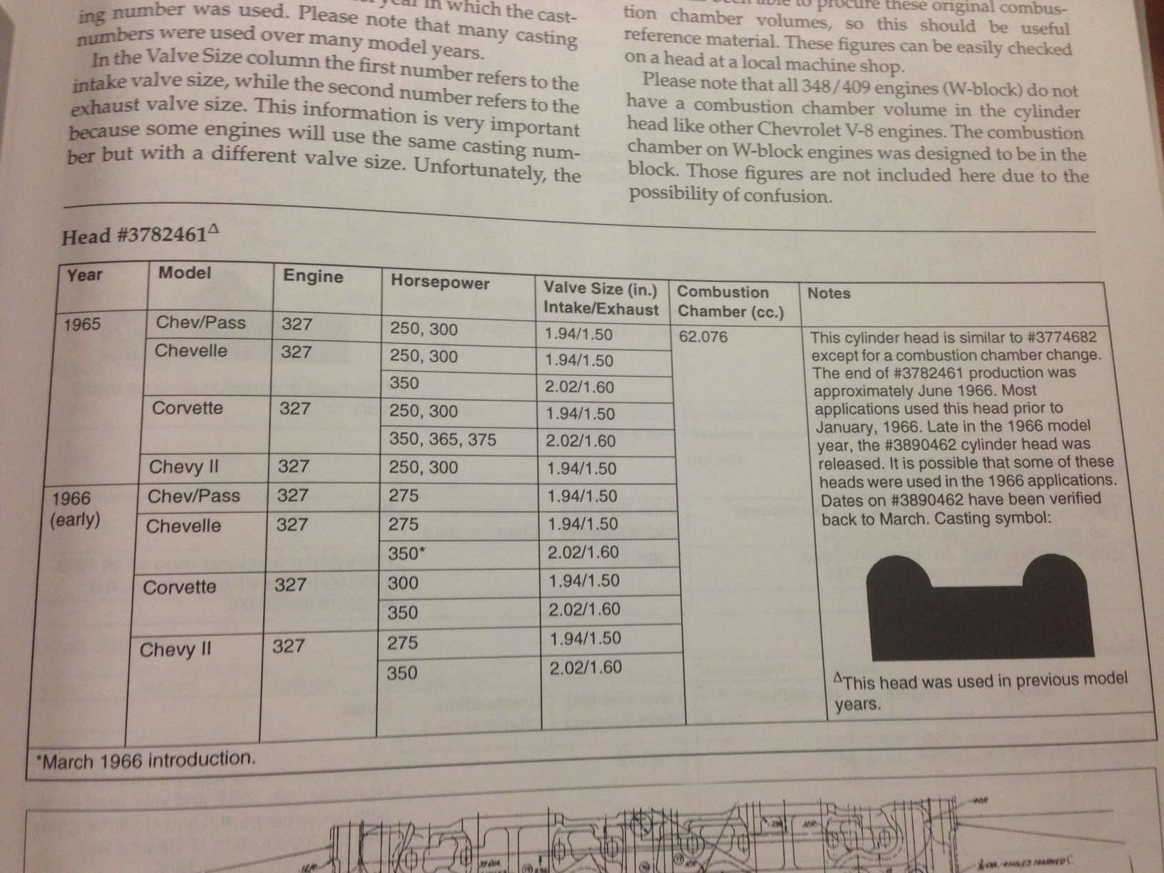

Keep in mind that some "double hump" heads were 1.94 valve heads.

I bet there were more with 1.94 than 2.02. Even the L79 heads were 1.94, right? Did an L79 ever has 291 head?

Some guy had this book, which confirmed my suspicions.
Thanks for that chart too - pretty interesting!
