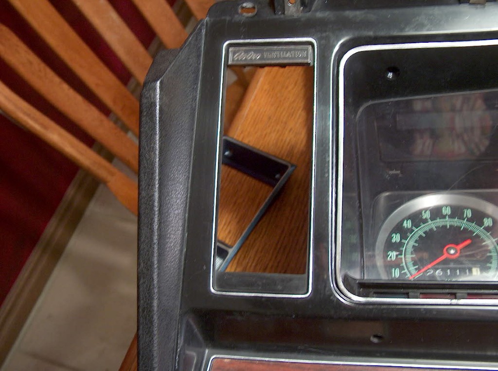

Like many 69 Camaro owners, my instrument cluster was in need of seriouos refurbishing. Like most, there were some broken tabs. Easy fix. Just epoxy new tabs. What about the missing silver or chrome on the trim and lettering.

The best part is that it cleans off with mineral spirits, which do not harm the plastic. So, if you make a small error, just get a Q-Tip dipped in mineral spirits and clean it off. Although it does take some effort to clean it if you don't get it right away.
Below are some before and after pics. The first pic I took after just hitting a few of the letters on my extra cluster. You can see on the before pics of my black cluster, there was almost no silver left.

It is not perfect. I am sure an actual re chrome process would yield closer to factroy results. But.. for the time and money involved, does a pretty good job.
