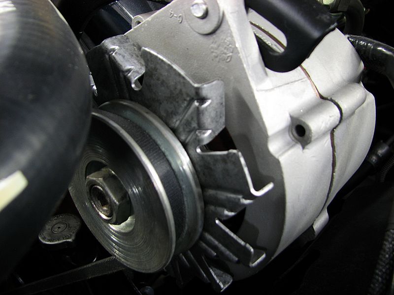

If I don't/can't do the cadmium process, what is a suitable substitute plating process that is more readily available? Were the finishes the same for '70 as well as '69 high rpm alternators (-837)? Here is a photo of my Blk/Red 'velle taken on the 2nd day after delivery (note finishes on alternator fan and deep groove pulley):

Sam, I am not positive as I've never read where anybody has had original parts analized by a lab.
I think that the 70 LT-1 Deep Groove pulley was Cadmium plated or Clear Zinc, and the fan was clear zinc.
Todays platers used a brightner solution after the zinc plating. I'm not sure that was the case when these parts were new, thus they tarnished much faster.
Just my .02

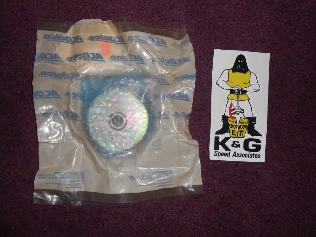

<div class="ubbcode-block"><div class="ubbcode-header">Originally Posted By: TheNovaMan</div><div class="ubbcode-body">Did some alternators come with gold cadmium plated fans and/or pulleys? </div></div>
I do not believe gold was ever OE. GMPD serviced a generic deep-groove alternator pulley [#3829387] for many years that had a gold finish.

This is how GM was finishing them several years ago.
