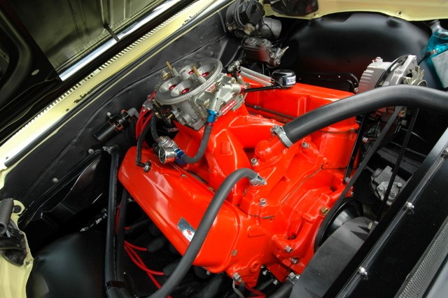

I've been toying with the idea of making some changes to my 64 Chevelle. I have had it built this way for 10 years, and while I'm not tired of the car, I thought it might be fun to make some reversible changes for the next couple of summers.
If I do, they would be of the Day 2 era.

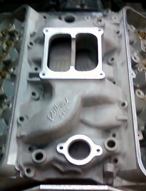

I have two of the old Edelbrock, dual plane intakes that are Dominator flanged. I would just have to add spacers for the tall deck block. Other than that, I'm asking for ideas on everything. Wheels, tires, under hood, interior and ride height.

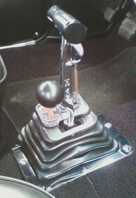

This is the shifter in my 65, so I say put a console back in it.

I can't put the console back in. The tunnel has been modified for the Jerico and it will not lay back onto the tunnel.

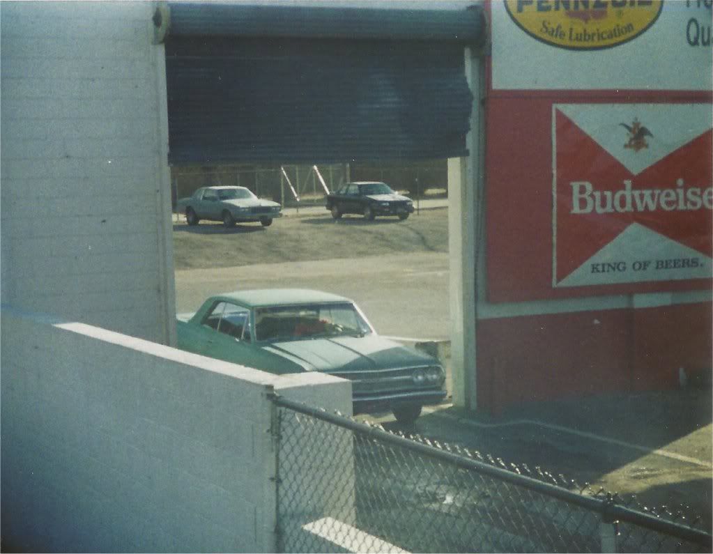

As much as that Cowl hood is cool on that Chevelle Tracy, it kinda sticks out as a departure from a 1960's vibe. I've seen little Pontiac or generic type scoups, Ford Tunerbolt, Corvette Stinger hoods all done in back-in-the-day but never a Cowl hood. It was pretty common just to jack the back of the hood up as you can see in this picture at Atco. That is what I do.

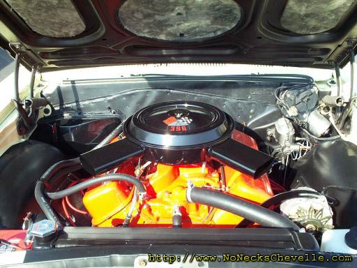

The attached picture is when I had the RPM intake installed. I took a stock Camaro air cleaner and modified it to a dual snorkle. Everything fit under the stock hood, but I had a Pro Systems 4150 carb. at that time.
BTW..the cowl hood is all steel. I made the scoop out of 18 gauge steel.

Question about your Homemade dual snorkel... what are the snorkles from? It looks cool! [img]<<GRAEMLIN_URL>>/smile.gif[/img]

Thank you.
I made them from 18 gauge steel. They are two pieces,( a top and bottom ). Radius was done in a slip roll and then spot welded together down the length. This way they have a factory seamed look.
